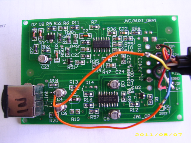

After cutting two tracks on the PI board and routing one side to the cable and the other side to the socket, reversing the audio, things worked fine and the AI unit now switches to the AUX and overrides either the tape or the Radio.
The audio units sound level is same as Radio or Tape.
Doing a the head unit is much easier than routing sound through from the trunk. I am using the Motorola T605 so can now stream music from Pandora radio and the iPod as desired.
Hope this helps others interface sound in non destructively.

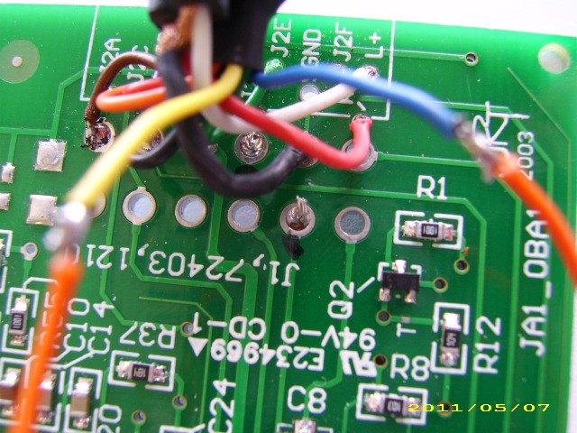

Unsolder the two wires that are the audio out from the cable and add extensions.
![Alpine Ainet/Aux RCA input switcher not working: 2000 XK8 Premium Sound-dsci0061.jpg](https://www.jaguarforums.com/forum/attachments/xk8-xkr-x100-17/10145d1480965877t-alpine-ainet-aux-rca-input-switcher-not-working-2000-xk8-premium-sound-dsci0061.jpg)
Cut two tracks that are the audio in that go to the socket.
![Alpine Ainet/Aux RCA input switcher not working: 2000 XK8 Premium Sound-dsci0059.jpg](https://www.jaguarforums.com/forum/attachments/xk8-xkr-x100-17/10142d1480965877t-alpine-ainet-aux-rca-input-switcher-not-working-2000-xk8-premium-sound-dsci0059.jpg)
Add extensions from the socket that is now audio out to where the two audio wires from the cable attached.
![Alpine Ainet/Aux RCA input switcher not working: 2000 XK8 Premium Sound-dsci0060.jpg](https://www.jaguarforums.com/forum/attachments/xk8-xkr-x100-17/10143d1480965877t-alpine-ainet-aux-rca-input-switcher-not-working-2000-xk8-premium-sound-dsci0060.jpg)
Add the cable extensions to the capacitor side of the two tracks that were cut. This is now audio IN from the cable.

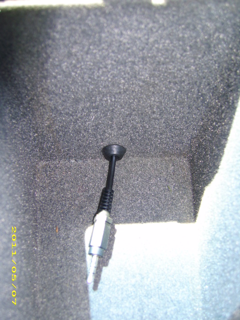

Added a 3.5 mm cable in the console for audio in.

OK I decided to dive back into mine and see if I could find out why one of my PIE switchers is working and the other not, as well as to look at the reverse connection situation mentioned by dsetter.
First on my 2002 XKR simply plugging the AI net switcher between the CD changer, and amp is reversed as he says above.
Plugging it between the Nav and Amp is the correct orientation, and works in my car. Plugging it between the head unit and Nav also appears to be the correct orientation, however I did not actually try that last combination.
Next I popped the cases off both of my PIE switchers to see if one was wired incorrectly, hopefully explaining why one workedand the other doesn't. But, both seem to have the pigtail wired identically, as below.
![](http://www.wasserski-frankfurt.de/Jaguar/Jaguar-Line-In-01.jpg)
AI pin - pigtail wire color - signal name - PCB location shown on right side of board below.
1 - Brown - Accessory - J2A
2 - Purple - Data bus Gnd - J2B
3 - Orange - Data Bus - J2C
4 - Yellow - Right Signal Output- J2D
5 - Green - Signal Ground Output - J2E
6 - Blue - Left Signal Output - J2F
7 - Red - Batt - J2G
8 - Black - Ground - J2H
So everything seems in order there.
In regard to Jagosaurus posting on the signal ground being wired incorrectly. ( https://www.jaguarforums.com/forum/x...chering-49637/ ) I dug deeper into that because the signal grounds indeed are not all connected together as you might expect. The signal grounds all appear to run to an IC instead.
I pulled up the data sheet for this IC to see what it does ( http://www.datasheet4u.net/download.php?id=109176 ) Essentially it is a three input, 2 way switch. There are three outputs, A, B, and C, the input connected to those respective outputs are ax or ay, bx or by, and cx, or cy. These three pairs can all be selected individually, but in our case they are all selected together - so either all of the x inputs (female AI-net connector input), or all of the y inputs (RCA cable pair) are connected to the signal lines of the pigtail.
Selector lines A, B and C are all connected so they all switch together. When the signal to these is all 0;
ax (left ai-net in) is connected to A (left ai-net out)
cx (right AI-net in) is connected to C (right AI-net out)
bx (AI-net in signal ground) is connected to B (AI-net out signal ground)
When there is a signal on the RCAs, transistor Q2 switches the inputs;
ay (left RCA) is connected to A (left ai-net out)
cy (right RCA) is connected to C (right AI-net out)
bx (RCA signal ground) is connected to B (AI-net out signal ground)
So the signal ground is switched along with the left and right signals. I assume this is done to isolate noise on the grounds.
I'm going to borrow a picture here;
![](https://www.jaguarforums.com/forum/attachments/xk8-xkr-17/10143-alpine-ainet-aux-rca-input-switcher-not-working-2000-xk8-premium-sound-dsci0060-jpg)
The switching IC in question is at the bottom of the picture between C8 and C9 (filter capacitors on the RCA right and left signal inputs.)
C4 and C6, where the wires are soldered, are the filter caps for the AI-net signal inputs.
Finally, why is one of my units working, and the other not? R57 in the non-working unit is smoked! This is a 0 ohm resistor that connects the RCA signal ground to the PCB ground - thus explaining why this unit is noisy when using the RCAs. My "working unit" was damaged, and the C8 filter capacitor on the RCA left signal input is smashed flat and measures as a dead short - the signal still gets through to the IC, but there will be no filtering if I get a DC offset on that input.
So for now I plan to replace the 0 ohm resistor on the board that wasn't smashed. Though I'm not sure what fried it, maybe the reverse connection between the changer and amp I tried originally?
I'm also more anxious to get this finalized because my changer just decided to tell me "No disc" whenever I try to use it now, leaving me with only AM, and FM to listen to.

One question that came up was regarding the Ai-NET audio cable going to the CD changer unit. The CD unit has a short pigtail cord to the plug-in, and is taped in a bundle on the back of the CD changer unit. Unbolt the rack and gently pull it out, taking care of the short cable lengths of the various connectors. Untape the bundle, unplug the connection, and re-route the cables around to the left side of the rack. Plug the cable running to the "head" unit (in the dash) into the "head" plug in on the Alpine KCA-410C Versatile Link Terminal (VLT). The cable that comes with the VLT plugs into the "Changer 1" plug-in, and the other end into the pigtail connection to the CD Changer. Plug the Left and Right audio cable from the iPod VehicleDock into the "AUX 2" input.
Note, my 2003 Alpine stereo wasn't designed or have the ability to be able to control the switching between "changer 1" and "Changer 2" (or between AUX 1 and AUX 2) of this Alpine VLT unit, for those thinking about adding a second sound source, such as a DVD player to the second inputs. 2004 and newer Alpine stereos may be able to do this. But the intent here was to get the iPod audio interjected into the stereo, which works really well using this unit! When the "IN-INT" cable is grounded, the "AUX 2" (iPod audio) overrides the input from the CD Changer (This wire was supposed to be used so that devices such as vehicle cellphone circuitry (or GPS audio) would override any other input).
So wiring a switch to ground will do the trick. This is the micro-switch that I put inside the center console tray area, as seen in the photos in the September magazine.
I have additional photos of different aspects of the installation, if anyone needs, such as the location of the vehicledock under the center console tray.
