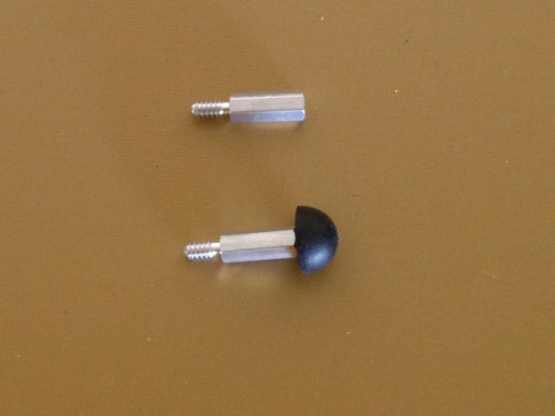

I checked the McMaster-Carr web and found one that should work. Thanks Charlie for the lead. I just ordered them today and will post on how they work. I agree with XKRacer on the push in type coming out, but these are attached by a nut as the screw is molded in to the top bumper assembly. A is 7/16" B 1/4" C 1/4' thread size 6/32. Package of 25 is $6.64.

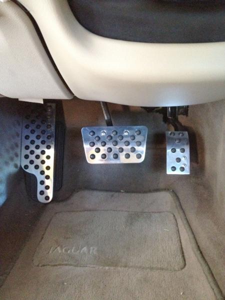

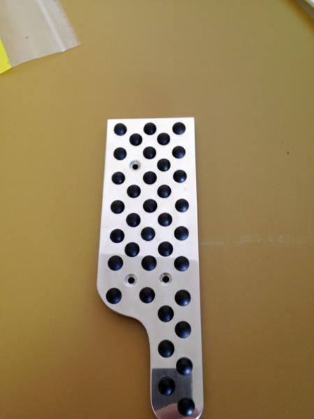

Size:  86.3 KBName:  jagpedals011_zps0f4d883a.jpg
Size:  106.8 KBI installed the rubber inserts to my pedals and I think they look very nice. The pedals feel real nice with the rubber inserts installed. The nuts I got were locking type and extra small so they fit in the indents of my pedals. If you want to install these, order 75 of the rubber inserts. I only ordered 50 and as you can see I could have uses a few more to completely fill all the holes in my foot rest. I plan to order another 25 and use some of them for the foot rest and the remaining ones for spares.

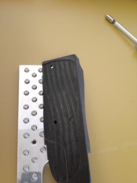

Building on what Bill did I got some of the same rubber inserts and also some studs to increase the length.
Leave out several of the inserts to mark the location on the original dead pedal.
Drill some 7/32 holes in the plastic. You may also need enlarge the holes in the pedal to this size so the stud will pass through. The gas pedal was fine, but the dead pedal wasn't quite large enough.

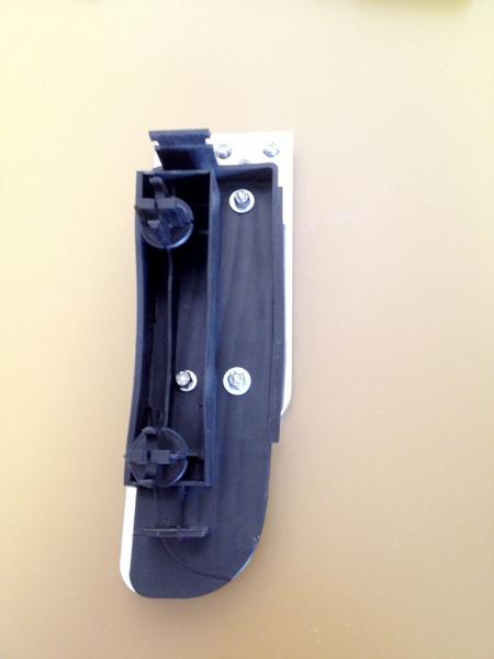

Bolt it together from the back side.
