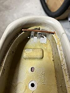

After many attempts, double sided foam tape, Velcro, JBweld… etc…
I started to try Fdbrock’s wire method… https://www.jaguarforums.com/forum/x...holder-129577/
Then I thought… couldn’t I just run it straight across? 🤔
So I did… so far it’s working!
