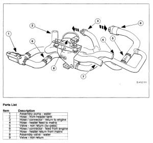

I have run into what looks to be an expensive repair job. Two months ago I had my trusted Independent Mechanic flush my Radiator while replacing my Overflow Tank. Immediately after that it started smelling of burnt anti-freeze and losing a bit of A-F. Today he did a pressure test and after quite a while he found it was pooling a small bit of A-F in the rear of the engine. It seems to be coming from under the Intake Manifold. He said that there is a hose that runs under there, but that it's a big job to get at it. We decided to check with you guys here to see if there is any recourse other than removing the Intake Manifold. If there is something else that may be at fault, I would sure like to know about it before he starts really digging deeper. He's a great mechanic, but not completely up to date on the nuances of XK8'R's.
I found 3 old posts that made some mention of that problem.
This one was by Gus: "If you think you have a leak you can examine your cars hoses and see if you can find it and chances are that you will not locate the problem the first try. I have been told of leak at the seams of the coolant tank and or the hose that goes under the manifold to the bulkhead and it is no pleasure to replace."
Another by Oldmots: "These cars are known for the failure of the heater hoses that run under the intake manifold. The heat in there can dry the coolant before it runs onto the ground or it will run off the rear of the engine where you are not looking for it."
Good info from Brutal: "And replace the 2 heater hoses while you're under there."
Is there anything that I should know about this problem/solution? Many, many thanks in advance. I really would like to be more knowledgeable about this issue.

Unfortunatly brian, its highly probable that theyre leaking. And 1 of the draw backs to haveing a supercharged engine. You have to remove the intercoolers and blower to access. Replace everything including the hoses for the bypass valve for the blower and all gaskets. You only want to go in there once, OH AND REPLACE THE HEATER HOSE MATRIX HOSES BEHIND THE ENGINE TOO WHILE YOU HAVE EVERYTHING OUT OF THE WAY, ITS SOOOOOOO MUCH EASLIER

Pulling the super charger is easlier said than done. And compared to this same repair on n/a, its a hellofalot more work involved. Yes its just nuts and bolts. And I wouldnt relate it to a coolant flush, youre due. Its all plastic and rubber and it all goes away with time. We put more heater cores in due to plugged passages than any leaks i can ever remember. And the intercoolers and hat passages on sc cars are very prone to this as well
