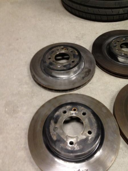

Thumbs up Resolved!
I found a local automotive machine shop that does balancing work on flywheels, pressure plates and that sort of thing. It was an old school place, the kind where the walls are covered with pictures of all the race cars they have run over the years, dating back to the 70s. Chevys, Dodges, and even a Healey 3000 among them.
In talking to the guy, he said that out of balance brake rotors are reasonably common, and he even gets the occasional brand new vehicles from the local Ford and Chevy dealers. Usually it's the big trucks and Suburbans that have trouble.
Since this was a test as much as anything, he said he would balance them with clay first so he could weigh it and we'd know how far out they were.
The next day I get a call that they are done and he gives me the rundown:
LF = 2g
RF = 16g
LR = 50g
RR = 21g
If those numbers look big it's because they are HUGE! 3 out of 4 rotors were outside what you might call acceptable, and one was off by almost 2oz.
That's crazy. So crazy he didn't believe it was right and had one of his assistants tear down the setup and re-do it to confirm the result.
He ground them around the hub area to get them in balance and I happily paid the man the $200. The picture is of the 50g one before painting.
I shot some new paint on them last night, let them dry and put them back on this morning.
After a test run I can confirm that the vibration is gone. There is no discernible shake at any speed up to about 100mph so I'm going to call it fixed. Finally!
Through all this I learned a couple of things.
1) I won't trust that a brake rotor is in balance ever again. Next time I do a brake job I'll just take the new rotors and have the balance checked. I was lulled into complacency when I saw the mill marks on them from the factory, but not again!
2) Centrics doesn't have the greatest quality control. Their machining seems fine and they run true but were WAY out of balance.
I won't go so far as to say that others should avoid Centrics because even including what I paid to have them balanced they are still 1/3 the cost of an OEM Brembo part.
At this point, I wouldn't trust a rotor to be balanced no matter what the price was and would get a real Brembo one checked, just the same.
