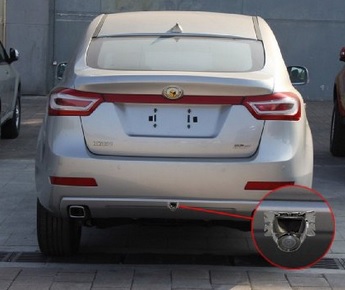

I couldn't find a photo of a Jaguar but isn't the rear bumper a better location?
A camera on the boot lid would be in plain sight and vulnerable to the wrong kind of attention when the vehicle was parked.

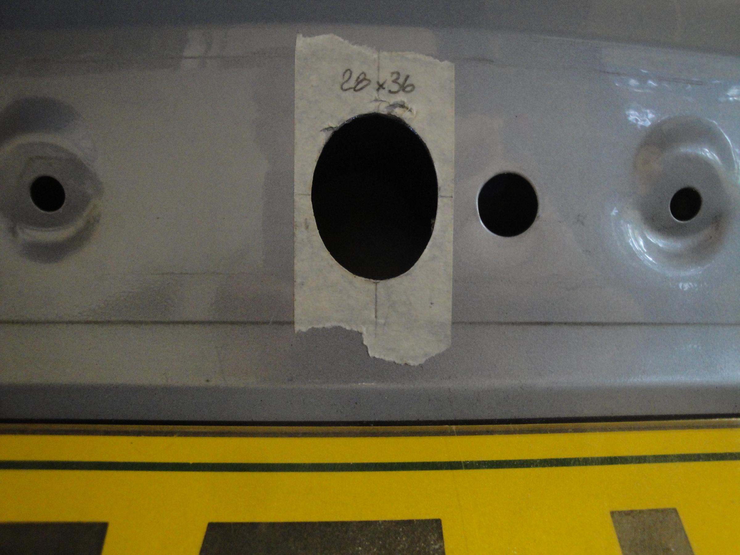

I'm in the middle of fitting a back-up camera system which plays through the OEM Satnav. I picked a camera position that I'd seen used in an S Type and that is in place of the trunk switch in the trunk plinth. The camera, a bullet style, is fitted through the boot lid, but up against the aperture left by removing the switch, as shown below. The aperture does not obscure the line of view of the camera.
Fortuitously, there is room in the space behind the plinth to allow the switch to be repositioned as shown below

I like your solution Astromorg. Do you have details on the install, like camera diameter, where to run the wires and whatever tips you have.
Old 03-10-2014, 05:07 PM
astromorg's Avatar
Join Date: Feb 2012
Location: Portsmouth, England
Posts: 1,067
Received 542 Likes on 354 Posts
This is very like the camera I used, but you need the NTSC not PAL version, plus a converter to change the signal to RGBs or RGsB if you intend to use the OEM satnav screen
This is a Bumper mounted water proof quality colour cameraAnd has a very wid
The hole in the trunk lid is shown in the photo. Because the angle of the body work is quite steep, I had to make special angled spacers to allow the camera to be mounted horizontally.
I ran the wiring - one two-core power lead and one video signal wire alongside the other wiring from the trunk lid to the trunk. I decided against trying to bundle all the wiring into one flexi tube at the hinge and just tie wrapped the new to the original flexi pipe.
