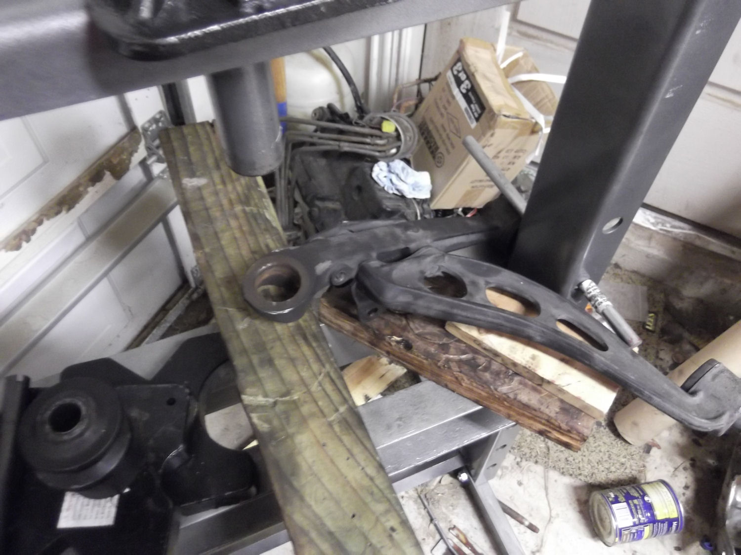

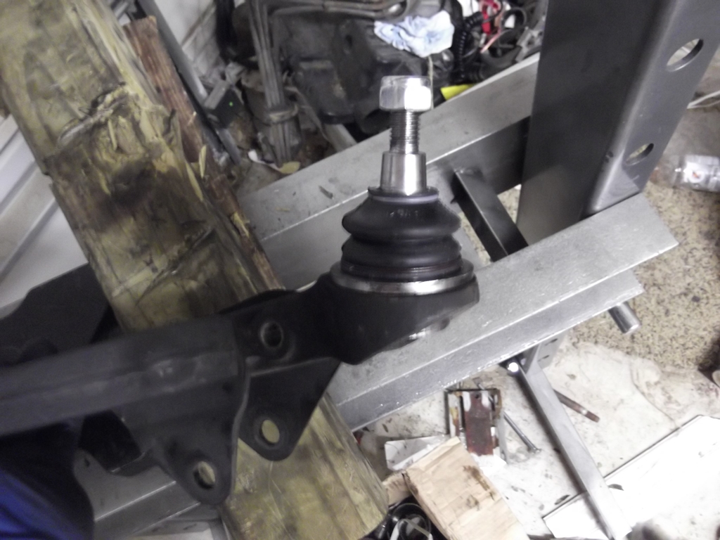

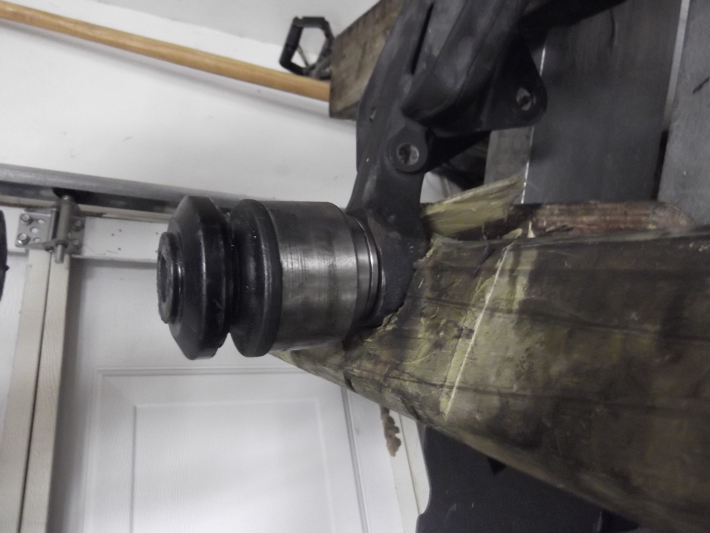

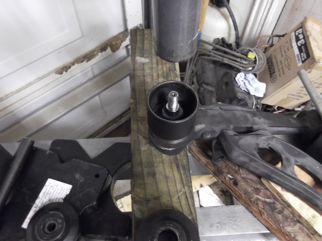

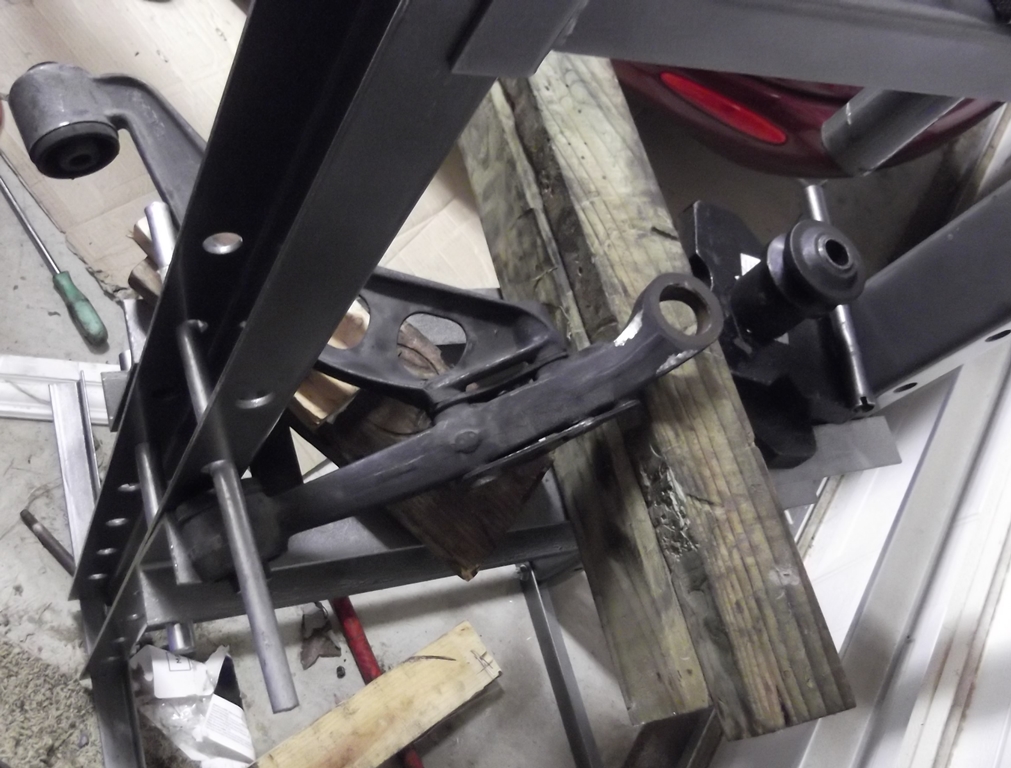

Pressed in the Lower Ball Joints - man they are tough.
I'm used to stamped sheet metal lower control arms and not Steel Forgings When Pressing in/out Lower ball joints. I can see why my Ball joints hadto come from the UK, nobody in the US wants to tackle these.
The Pressing out seemed to take a lot of 20 ton press going in took less force but way more finesse.
here is the Arm on the press I used a 4x4 and various wood blocks to level:
The Secret to pressing the ball joint in is keeping the inboard side from going up, so a 7/16" metal bar does that. Smaller than 3/8" will bend.
I used various bits from the old pressed out wheel bearings to protect the new ball joint during installation. This is a bearing race ring on the ball joint:
This is a cylinder from an autozone loan-a-tool ball joint press, but one size is too big, the other too small...
And then you stack the Disks from the Kit...
But that was sketchy because the diameter was too big, so I just used an entire wheel bearing, instead. The cups from the ball joint kit worked great on a partially broken bearing:
Note the Crushing of the 4X4 that took place during the pressing.
all done:

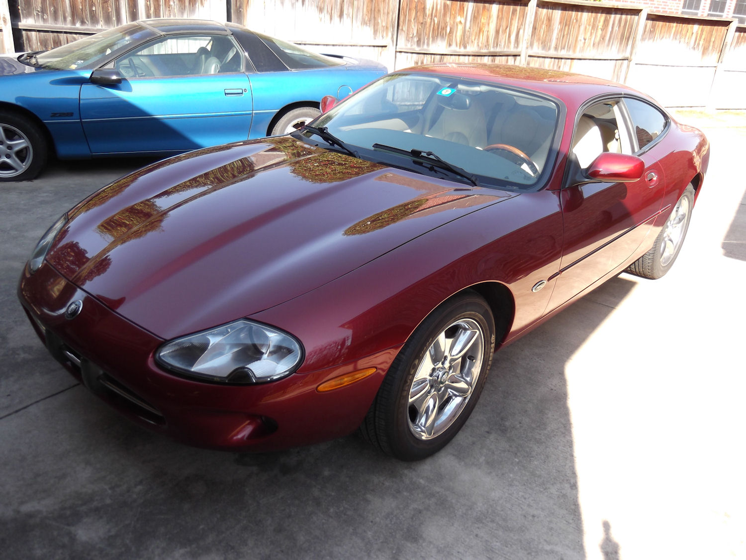

My Hub nut socket arrived from England Yesterday and I'm back on the road. It's great having a silent front end... No howls, no clunks, no rattles, no creaks.
I looks like the driver side inner tie rod may be bad (lots of play), but the car still tracks and drives straight, even without an alignment. Must be the caster.
New brakes work silently. The ABS light went out. no pulling to the left or right, I think I had success. Put my tools away and swept the garage to celebrate.
Here are some pictures.
Finally out of the garage and into the light, next to the Donor Camaro vZ28.
Fender Height is 14.5" before any major settling/foam compression. Its actually a little taller than the stock springs/mounts:
Was finally able to take some pictures:
