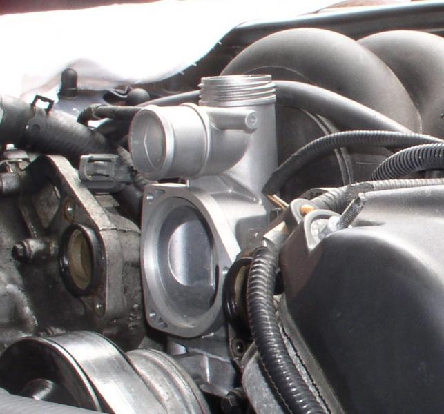

Here's as a good a pic as I have of the housing without the Cap.
Broke off thermostat housing port to expansion tank bleeder hose...-15a-thermostat-housing.jpg
The threads are cleanly cut and also note the smooth finish on the Thermostat Housing body. The one I sent back was a very rough casting and, as well as the threads not being properly machined, was of poorer quality. I understand that there's a lot of these sub standard Housings around on the aftermarket.
As you are having problems getting a good seal on the Cap, a plastic one will be better as it is slightly more flexible that the aluminium one.
