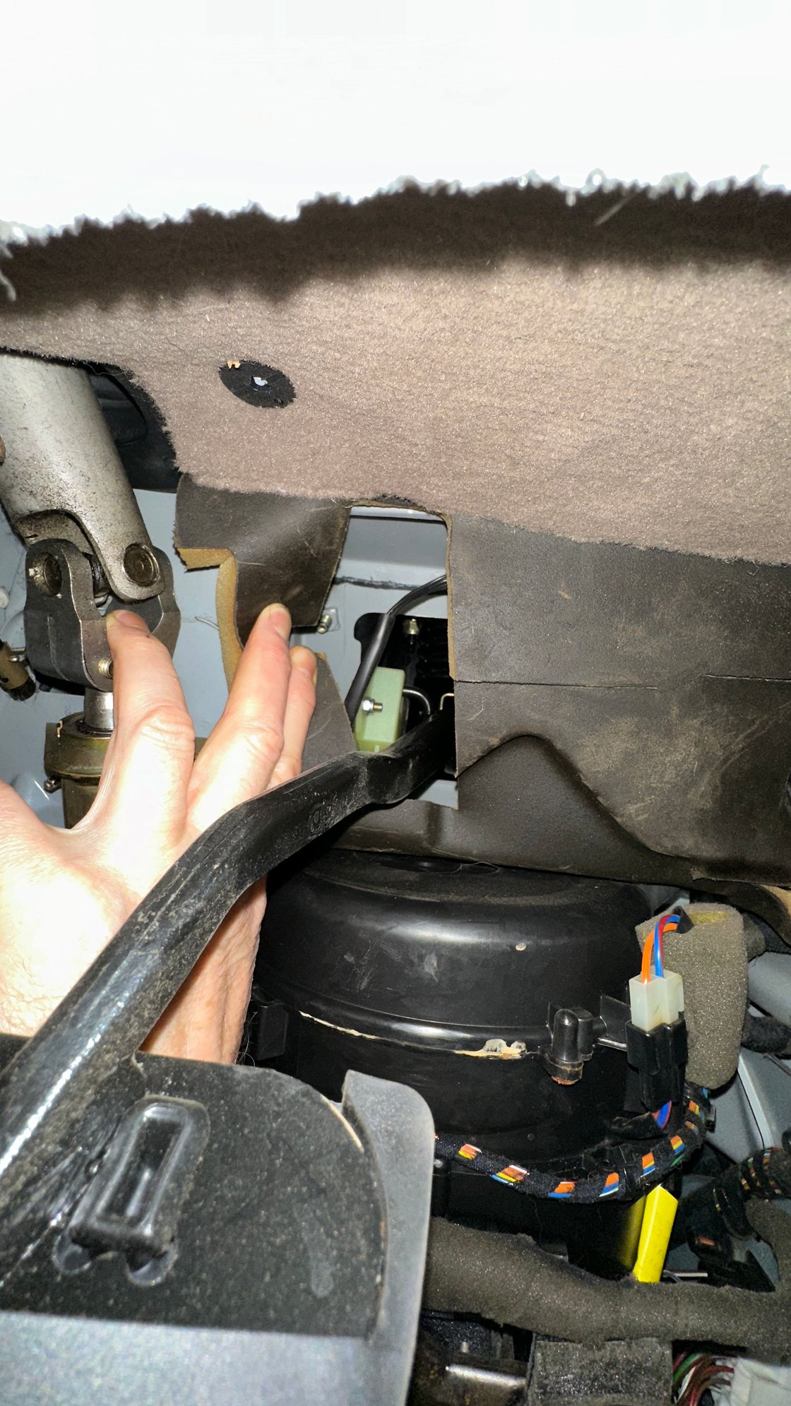

I replaced my brake switch and now my brake lights stay on. I am wondering if I could have installed it backward. I am not sure it is possible to do, but with my luck it may have happened. If not maybe it is a bad switch. i am not looking forward to replacing it again.
The first pic is what I want from you and the second is showing you how to place your camera.

With Brake lights stuck on, the gearbox will not change up gears either. Check if this is so with a very short drive!
If this is the case, then check post #14 in this thread, https://www.jaguarforums.com/forum/x...t-gear-233677/

it seems to change gears fine, i have been driving for a few weeks like this until someone told me.
