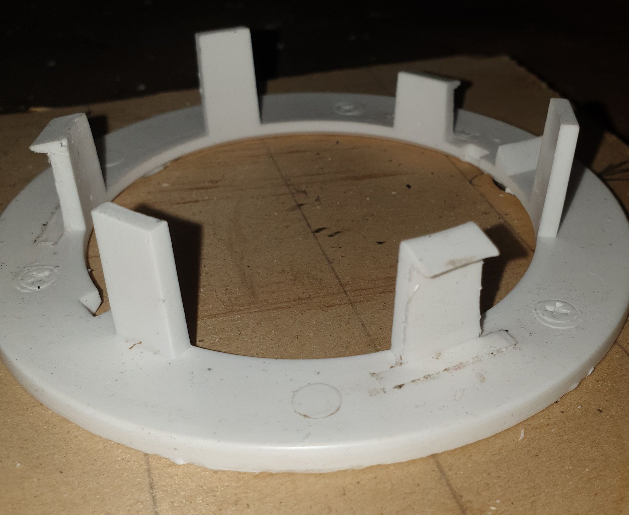

Hi,
I started building new front struts with all new parts for my XKR. Coil Springs, shocks, seat, upper mount. But how many Spring Packer on the Lower Seat do I need? I stopped because I only purchased 1 per side. I saw pictures with up to 3 per side.
Thanks,
Rich

Just one per side. I don't think they stack very well, and assume it's to adjust for spring sag when they use more than one.

Curious the white packer that came with the spring, it is cheap and falling off one of the springs, it's tapered. Does that get installed also?

Yes.

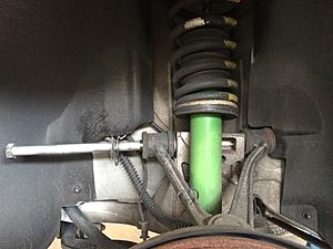

Originally Posted by rothwell
Yes.
IMHO not both, black or white......(but it seems there is no limit).

I just did mine and it had 3 black ones and the white "required" one... I got rid of two of the black ones and it's fine (and I did keep the white one also).

Thanks all. I appreciate you patience with my Q's. I wanted to do this the right way. As blindside said, mine also had three. But with all your advice i'm going to one. Thanks again!

It amazes me though, that with the engineering in the car, there is not a solid spec. Rothwells pictures are great, that looks like there are 2 installed.
