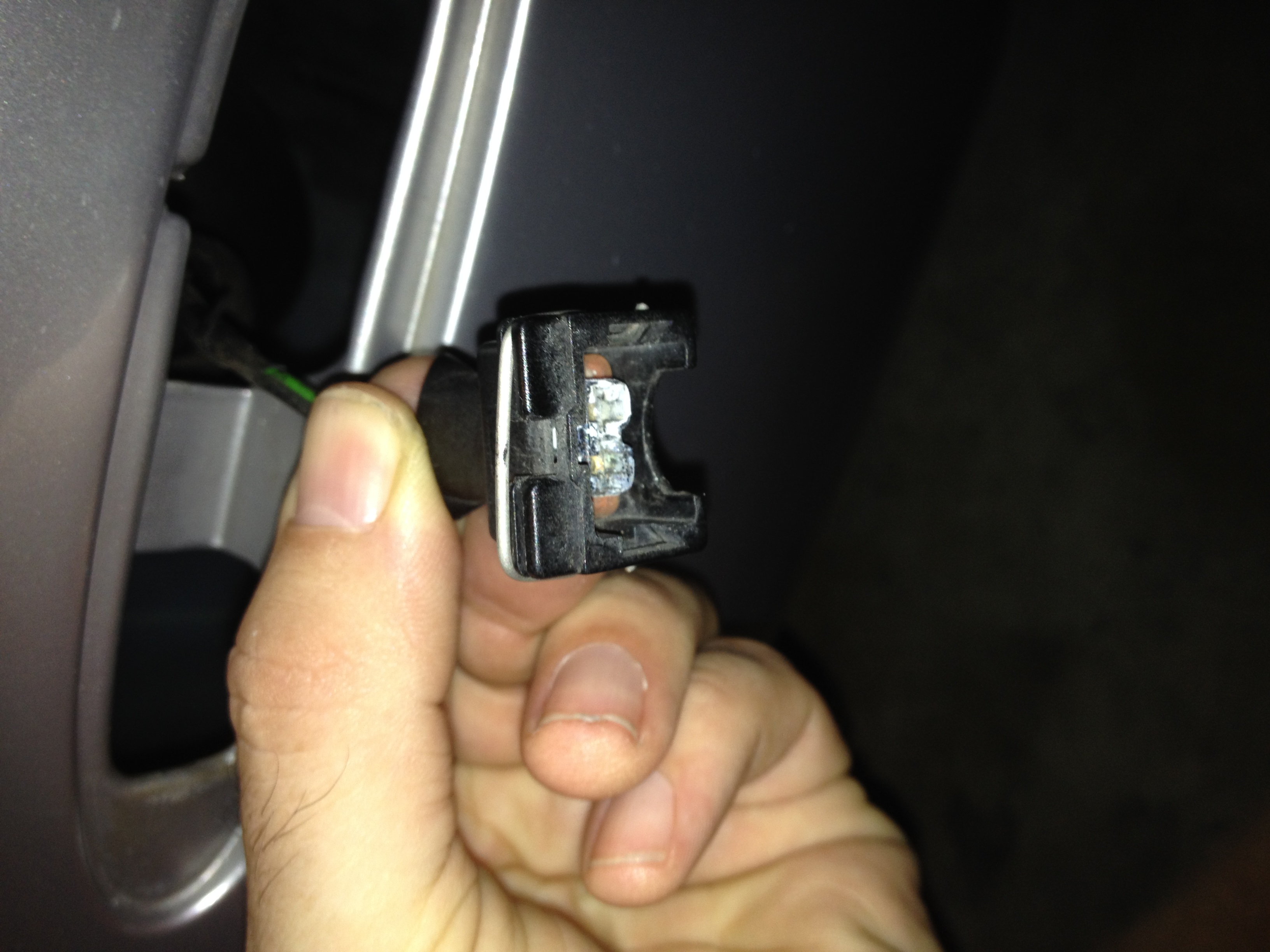

Hi...
I'm in the U.S.. I need to replace the bulb holders (see pic) all around for side marker lights. Plus to more for side signal lights (fender). I've looked up the 1203522 but all I get is UK and Euro listings. Expensive part and shipping - with a long wait. A US part number would be very helpful,,, if possible. Anyone?

Originally Posted by JayJagJay
Hi...
I need the part that this photographed part plugs into. Here is the one on my 2001 xk8 drivers side front.
Attached Thumbnails Corroded Rear Side Marker Lamp Socket-img_1800.jpg   Corroded Rear Side Marker Lamp Socket-img_1801.jpg
Give me a little time. I'll dig it up. Make me do it and don't be afraid to remind me. Ok?
I figured this out when I moved my side indicators into the front marker. It's an EV1 connector primarily used on older fuel injection systems.
Female EV1 on Ebay
