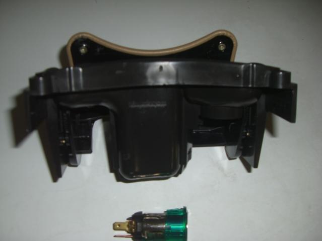

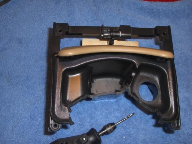

Default I pulled my ashtray to install an IPod player
I cut the ashtray to fit the Ipod, but it was never used as an ashtray in my car. Power was taken off the cigarette lighter, which was relocated to the rear of the consul compartment.
Attached Thumbnails Cover over lighter/ashtray won't stay closed-ashtray.jpg   Cover over lighter/ashtray won't stay closed-ipod.install-009.jpg   Cover over lighter/ashtray won't stay closed-ipod.install-017.jpg   Cover over lighter/ashtray won't stay closed-ipod.install-005.jpg   Cover over lighter/ashtray won't stay closed-ipod.install.3.jpg

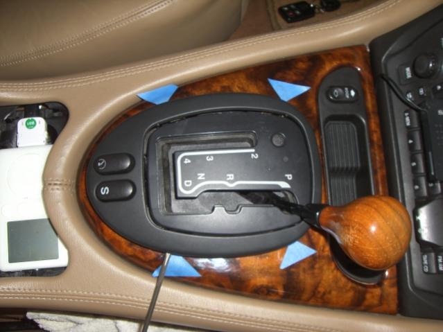

Here are some more pics to help you. Note the shifter top plate is held in place at four (4) locations as noted by the blue tape arrows. Use a pry bar or screwdriver wrapped in tape (to avoid scratches) at these locations. The plate is held in place by pop off fasteners.
Attached Thumbnails Cover over lighter/ashtray won't stay closed-remove.shift.plate.jpg   Cover over lighter/ashtray won't stay closed-ipod.mod-001.jpg   Cover over lighter/ashtray won't stay closed-ipod.mod-002.jpg   Cover over lighter/ashtray won't stay closed-ipod.mod-003.jpg   Cover over lighter/ashtray won't stay closed-ipod.mod-004.jpg

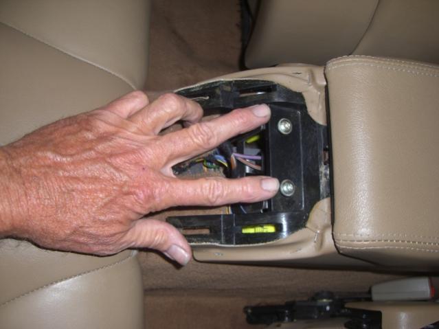

The rear of the consul is held in place by two (2) screws. These are accessed by popping off the leather trim cover at the rear as noted. You can use a tool or as in my case, I got my fingers underneath and lifted straight upwards. Good luck.
Attached Thumbnails Cover over lighter/ashtray won't stay closed-ipod.mod-008.jpg   Cover over lighter/ashtray won't stay closed-ipod.mod-009.jpg
