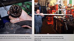

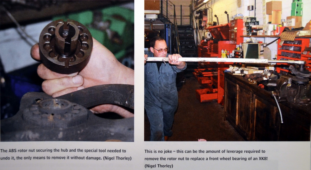

There's a similar photo in Nigel Thorley's You & Your Jaguar XK8 illustrating the force required:
Looks like you borrowed the scaffolding pole.

I have a front hub, taken off my xk8, in my garage ready to get a new bearing:
So waiting to see if this works, with an impact gun it may do!!
What I have noticed is that the hub which came off my facelift does not have a through hole in centre, whereas the one I got from ebay did: possibly from an earlier model hub or xj8? it also had a thinner backplate for the wheel bolts.
The reason I mention this is that without a vice for the hub with no hole you probably cant use a threaded rod to disassemble.
