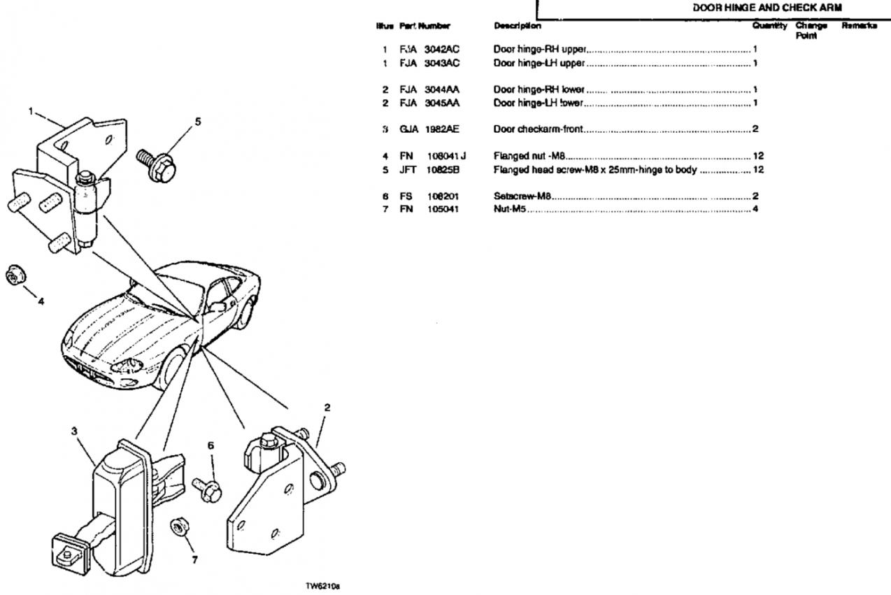

The door has 2 hinges and one check arm I call a damper or stay but regardless of what it is called the stay often emits a clocking noise when it is not lubricated. I use white lithium grease on the top, middle and bottom. Not a lot just only what is necessary. WD40 is great for short term lubricating and cleaning.

On Gus' diagram I tightened up setscrew #6 on the Check arm, where it bolts to the body of the car, and the sound went away. It didn't even feel loose, but I guess just enough to "pop". Thanks all!!

HINGES FIXED!! - NO MORE METAL POPPING SOUNDS!!! I discovered that the two small nuts of the check arm (see Gus's diagram above) mounted on the door, which are somewhat recessed were loose. A quick tightening and the door swings smoothly.
