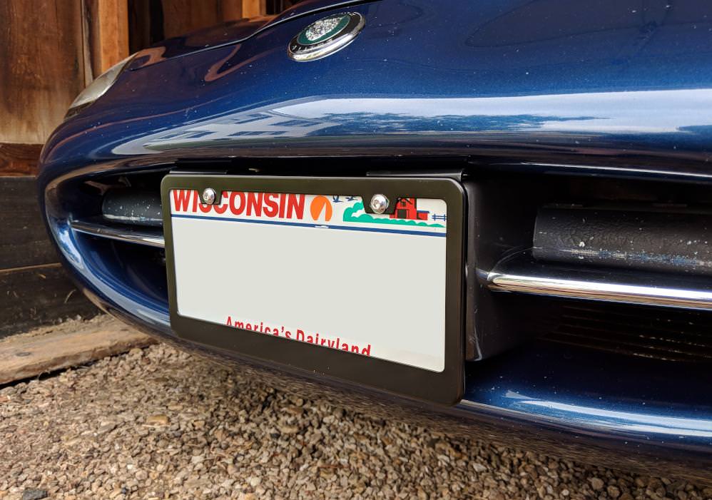

The finished product!

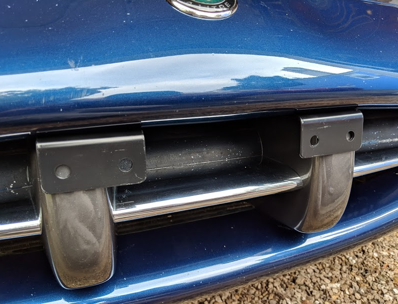

...and the finished product, un-finished afterwards!

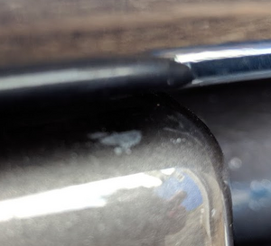

If you look at the top of the two gray vertical bars, you'll see the scuffs made as I added and removed the brackets. If you choose to use this method yourself, see what you can come up with for a scratch-minimizing solution (my suggestion would be some sort of scratch-resistant, non-marking tape applied to the top of said bars). If you don't apply something, you're certain to scratch the paint as I did - but because I was trying a variety of brackets to see what fit best yours will likely be less substantial.
Here's what the damage looks like, up close. Again, you kinda have to know that it's there to see it.

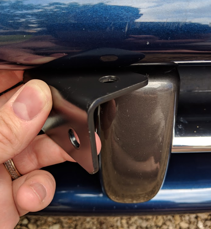

The method by which the brackets hold in place is pretty simple to understand.
The first thing you'll notice when you eventually jam the brackets in the gap between the gray bar and the upper lip - is that there's already a bit of friction there that keeps the bracket from moving.
If the car weren't moving around (like a car), the friction is almost certainly enough to hold the license plate in place on its own. But if you drive like me, you'll want to give it some extra support.
Please note: I realized later that there ought to be a rubber washer in between the steel washers and the car bumper. I haven't gone out to buy those yet, but if you decide to do this yourself, get some rubber washers the same size as the fender washers, one for each side.
Here's the solution I came up with; the bracket slides in, and is held against the bottom of the upper lip of the bumper by two fender washers, and tightened down by a wingnut.

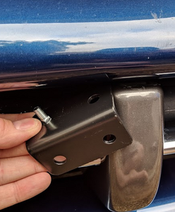

Step 1: Take that elevator bolt and jam it in the bracket
I'm using elevator bolts because they're the slimmest I could find that fit into this bracket - as in, without adding unnecessary thickness to the bracket, as it slides in the gap between the gray bar and the top lip of the bumper.
Note that you will use different holes for each bracket - pictured below is the bracket as it will fit into the left side; the right side would use the other hole. Don't add the washers or nut yet - the pic above is just for illustrative purposes!

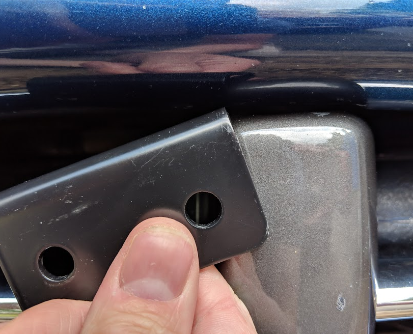

Step 2: Gently slide the bracket/bolt assembly in the gap between the gray bar and the top lip.
There's a bit of give in the bumper; so you could use your free hand to gently push the lip upward and make the slide a bit easier.
You will want to insert from the outside inwards, (that is, with the left bracket inserted on the left side of the left gray bar, and the right on the right side).
Now, gently slide the bracket toward the center of the gap...
...while pushing the outer edge of the bracket in, towards the front of the car.
