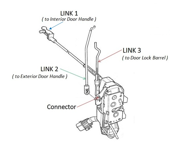

Plenty of good information in the FAQ’s except for disconnecting the link from the Door Latch to the Door Lock (LINK 3 in the drawing). It soon became obvious that any attempt to force the connector (circled in red) through the arm on the Door Latch would damage it.

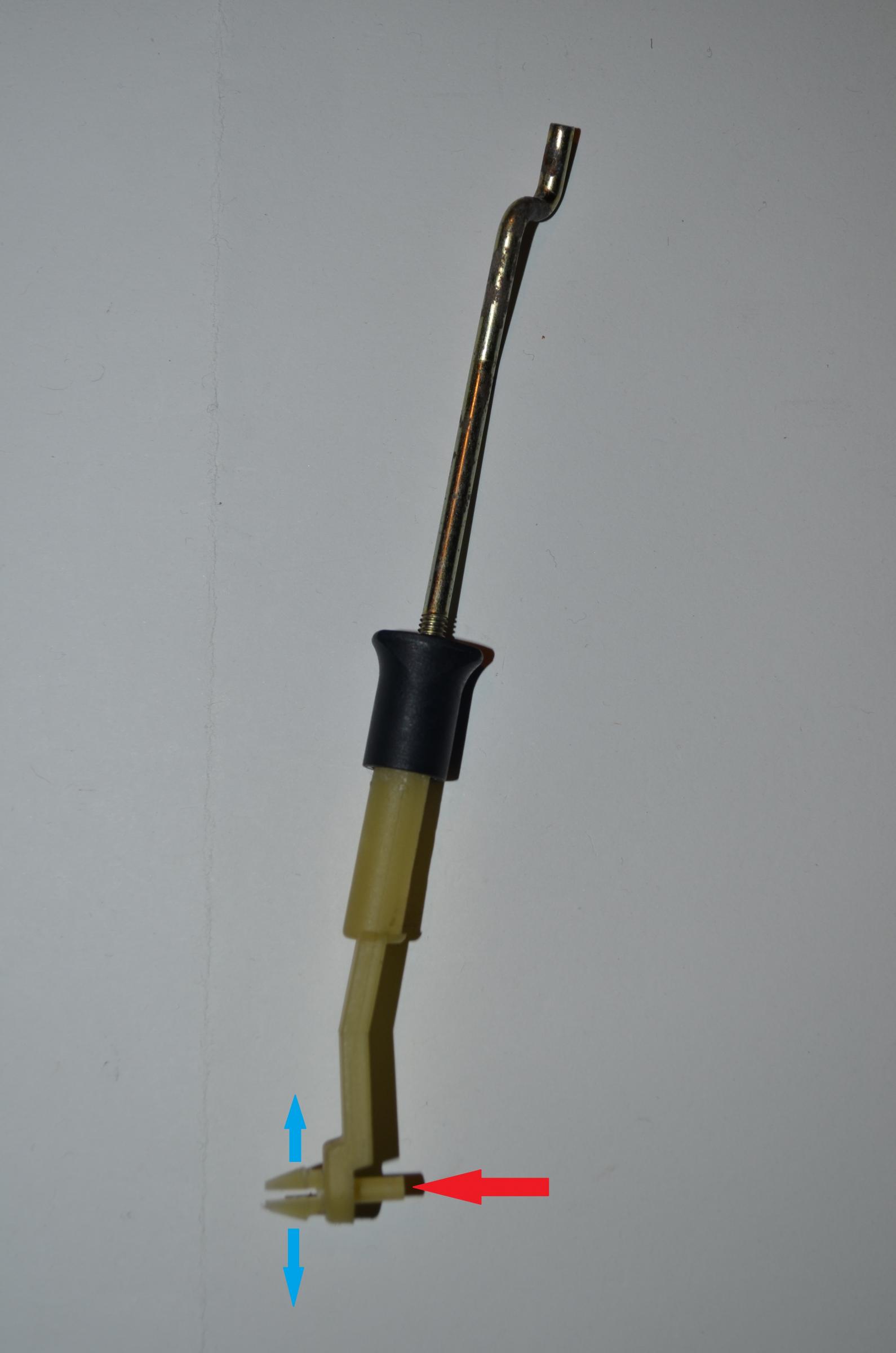

Inspecting the rear of the plastic clip with a mirror showed that it has four tabs (circled in red) which are fixed with a central locking pin. (the pin has been removed in this pic to show the tabs more clearly)
When the plastic link is originally fitted to the Door Latch during manufacture, the locking pin (arrowed in red) is pressed in the direction shown to spread the four tabs and prevent them from coming out of the arm in the door latch.

1. The black collar (arrowed in red) is pushed down the plastic section of LINK 3
2. This reveals a groove in the plastic section
3. The upper metal piece of LINK 3 can easily be pressed out of the plastic section (arrowed in red) which is left attached to the door latch. The upper metal section (arrowed in blue) stays attached to the door lock.
4. The door latch can then be removed from the vehicle.

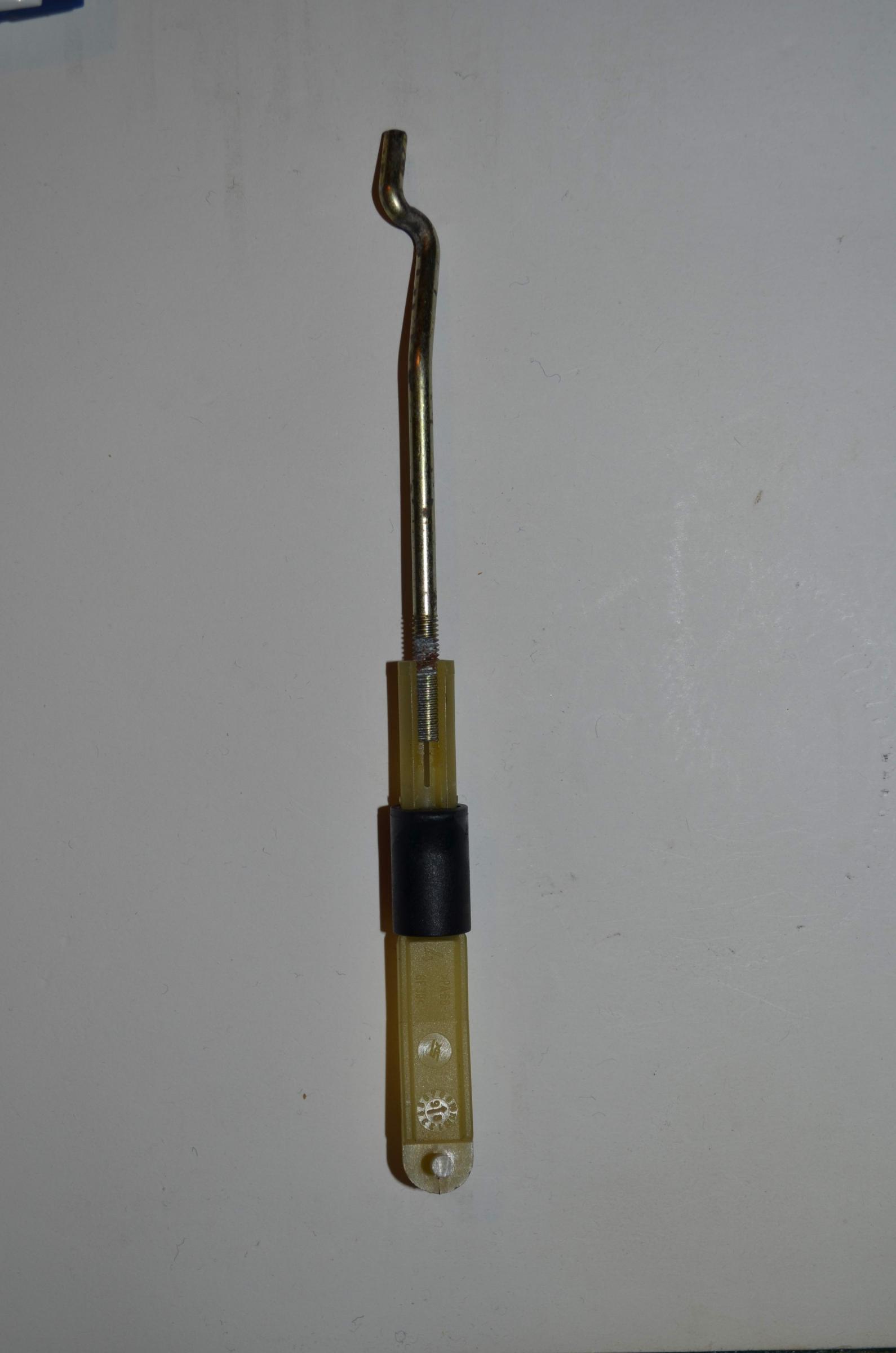

The following pic shows the plastic LINK 3 fitted to the door latch but without the locking pin. I’m sure this is adequate to hold the link in place but I replaced the locking pin.
On refitting the door latch to the vehicle, the two parts of LINK 3 are easily clipped back together and locked by sliding the black collar back up the plastic section.
