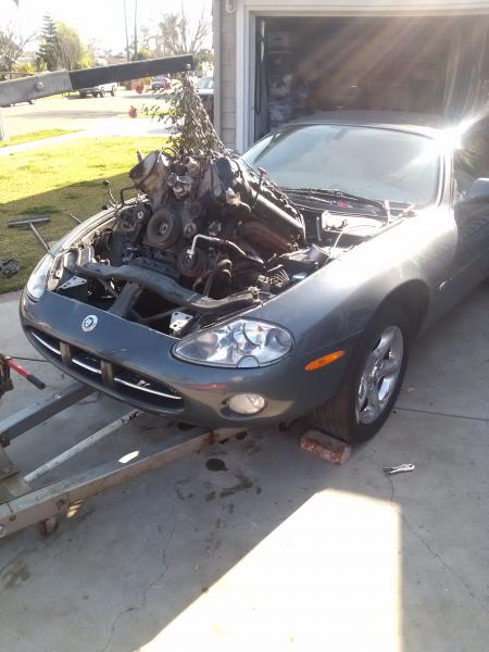

The factory must have gotten the XK8 wet, installed the engine then left it out in the sun to shrink the engine in... Man that engine bay is TIGHT.
When re-installing should I put the cats on BEFORE or after dropping the engine in?

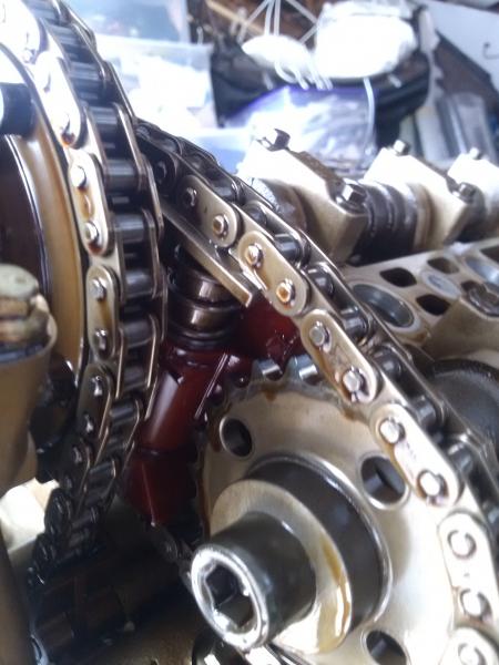

Attached Thumbnails Dropped valve seats-dsnyder586-105525-albums-garage-beast-5197-picture-cam00262-17292.jpg
Old 02-18-2013, 07:03 PM
The Coupe's Avatar
Join Date: Aug 2011
Location: South Carolina
Posts: 1,294
Received 370 Likes on 228 Posts
After. The cats aren't terribly difficult to install when the engine is in.
Good luck! Your photo both frightens and inspires me.

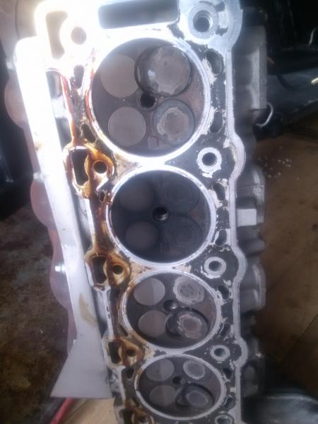

Ok, heads off and sent to the machine shop- only 6 dropped seats- not so bad. If all goes according to plan I should be able to have the long block built by Saturday.
Attached Thumbnails Dropped valve seats-dsnyder586-105525-albums-garage-beast-5197-picture-carnage-17321.jpg   Dropped valve seats-dsnyder586-105525-albums-garage-beast-5197-picture-ticking-time-bomb-17322.jpg

In the picture of the head surface shown above it looks like the gasket has been seeping for some time towards the exhaust side. Is that the case?

Anyways on second thought, that dark brown area looks like old oil that happened to drain out during removal.
