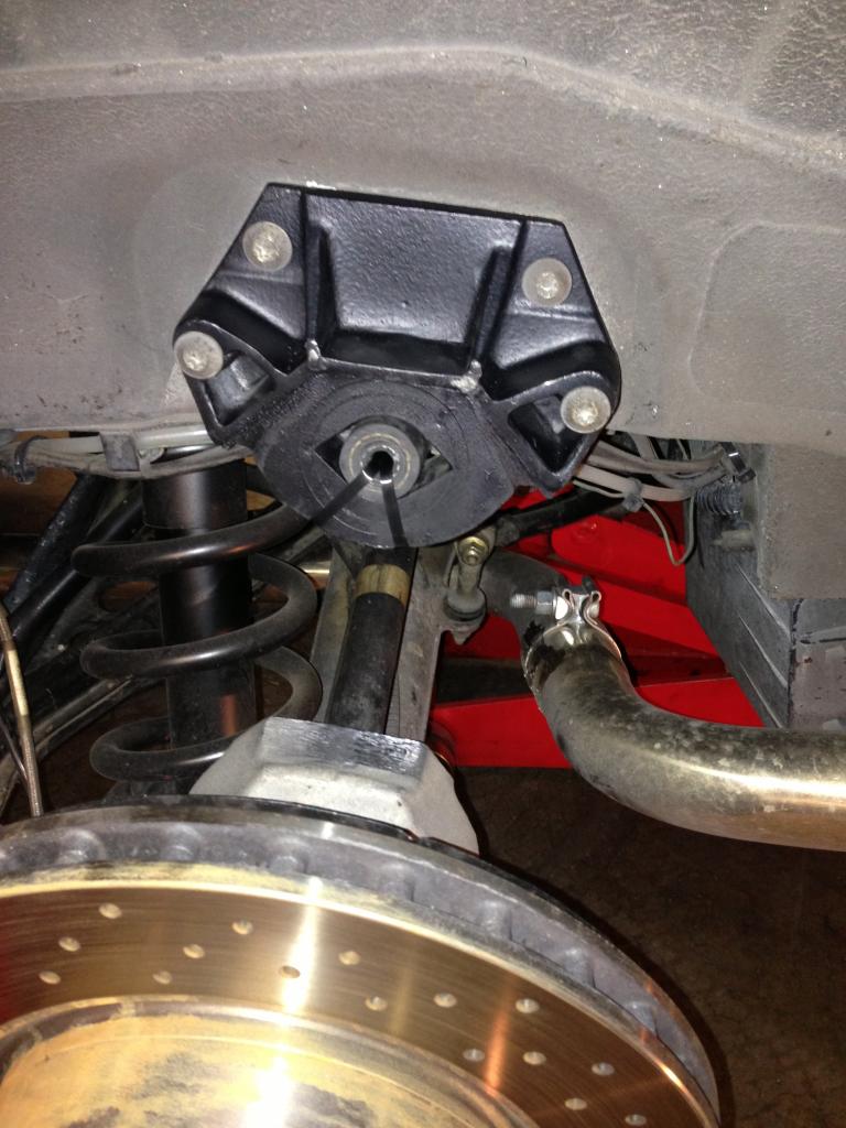

I had the new bump-stops installed by Falconworks. That solved the biggest problem. Now that the springs have settled, I am going to have the rear spring spacer added to raise the rear a small amount. That will help with WOT over bumps a bit, too.
Torn 13 year old stops:
New bump stops have an added rubber piece. We don't necessarily believe that the zip ties will actually hold for a long time, but it is fun to experiment:
Attached Thumbnails F & R lowered w/ Mina springs, want stiffer rear set. Opinions?-null_zpsf552dc2c.jpg   F & R lowered w/ Mina springs, want stiffer rear set. Opinions?-null_zps3b70f2cd.jpg
