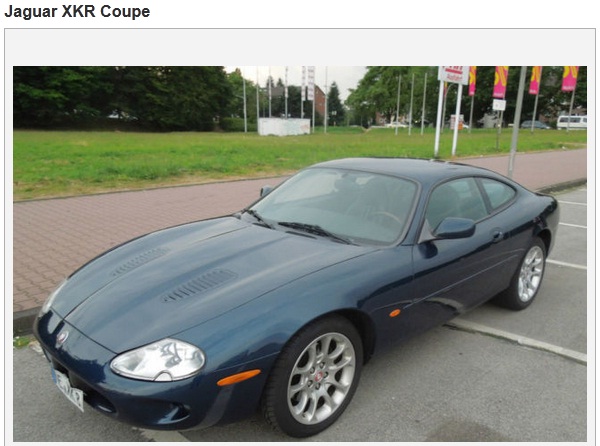

Last weekend I saw an offer, of course unintentional, if my girl-friend will ask, for a really cheap XKR MY2000 Coupe in a price-range that comes near to cars sold without even an engine. The Jag was offered 'with damaged engine'. I coudn't resist, gave the seller a call and finally we inspected the car in the dust - normally not a really good idea, i know ![Smile](https://www.jaguarforums.com/forum/images/smilies/smile.gif)
I awaited a rusty, damaged bunch of crap - but the car looked nearly good, was good driveable, only the engine running in "restricted performance", so max 3000 RPM.
We also found some minor issues like small rust-spots at the lower rear-end, a broken 1milehigh-antenna and a defektive microswitch in the left mirror-powerfold mechanism. The owner stated that the fuel pump was exchanged some month ago, also tensioners and chains, hoses below the sc, head gaskets and one head complete were changed. But he sweared the car was running a few thousand km after the overhaul...
But while inspecting the car we could see, that the relay for pump #2 in the trunk has been removed and the socket contacts shortened. What kind of repair is this???
The owner told me, that he even has not opened the rear fusebox ever. He invested nearly 5000 € into the now again broken car and, maybe, wants only to get rid of this 'Jaguar-rubbish' - a free car workshop was not able to repair.
So we did the 'crazy thing' and bought the car without a possibility to find out the cause for the engine problem - it seemed like something got wrong with the control-signals from ECM to fuel pumps. But who knows... Maybe the ECM burned or something like that.
OK, then 'Limping' home 80 km was not so much of fun, but we arrived without further problems.
After some fiddling with the circuits in the trunk fusebox we got the car running faultless on the 2nd pump with the control signal for the first one. Although we were confused by some kind of a backup mechanism for driving the two pumps by the ECM, that i can't really understand. Maybe it depends on, if the relay fails/is disconnected while running or before poweron?
I know, that the ECM has no possibilty of monitoring a pump failure, but i think it recognizes a relay-fault by resistance, goes into 'restricted mode' and switches the control-signal for this relay off.
So long story-short end: one Fuel Pump dead, a missing relay, a dead fuse and that's it. I can't even imagine, that a workshop was not able to diagnose this - and i really hope that they were not the man, that did the engine repair! We will see, ATM the engine runs smooth...
Maybe somebody here has a deeper understanding of the ECM's control logic, when it comes to the fuel pumps?
Last but not least, when i bought my XKR 4.2 a year ago, i was convinced, that silver looks best. But the dark-blue of the new arrival... hmm
Cheers Wolfgang
