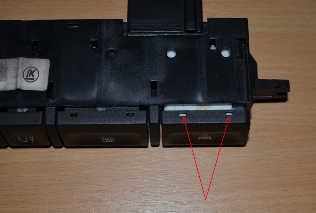

The switch seems to attract sticky dirt and loosening the two fixing screws alone will not fix it.
Once the switch pack is out of the console, the front cover can be popped off. It's secured on two pegs at the top ............
............. and two at the bottom:
With the cover off, the switch body can be properly cleaned.

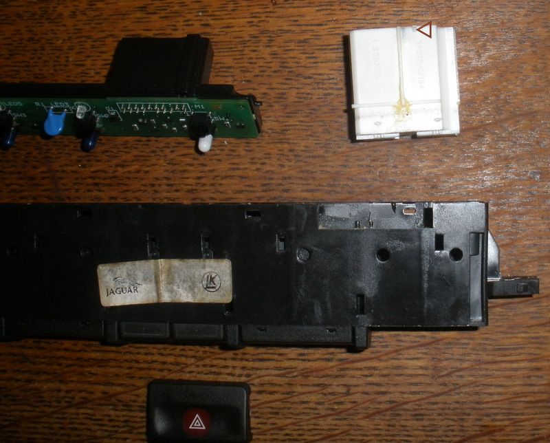

The problem seems to be there is a long plastic plunger bearing on a rather feeble keyboard type switch which, once the grease gets old + dirty, doesn't have the willpower to push the plunger out.
FIX
Use the Rev Sam's console removing video - easier in later cars since the shifter bezel is held on by four small Allen screws.
IMPORTANT
You MUST pull the console horizontally to the rear of the car until it clears the switch/radio cluster.
If you don't you will break the feeble plastic housings it slots into. Grrrrr!
Once you have the cluster unscrewed (6 phillips, don't drop them into the transmission tunnel) you can unplug the switch module with DSC, Hazard etc. and take it somewhere warm.
Remove the PCB from the back, then follow Graham's instructions to remove the front of the switches.
With a fine screwdriver lift the body clear of the little locking tab (arrow)
The plunger can then be pushed backwards out of the body and body + plunger cleaned and given a dose of silicone spray.
Do the same with any switch plungers that feel sticky.
That's it.

I added some additional pics to an old thread for more detail on the Hazard/Traction buttons so it's a little easier to visualize what's happening behind the scenes before undertaking removing the console and getting the HVAC stack out without breaking that very fragile plastic "console switch mounting cover" bezel that surrounds the whole HVAC/radio stack.
Rear view of hazard switch inner button.
The middle buttons are similar but smaller and tend not to stick.
The 4 channels it slides in should be clean and lubricated.
This is the actual underlying button. When pressed the top 2 layers are flush with the 3rd layer. The button is spring loaded and does not stat in when pressed
The nub between the 2 small squares is what presses the underlying button (rear view of inner button).
The bigger round hole is for the backlighting bulb, the smaller one is only used on the buttons that have an LED on indicator led like the seat heaters or Trac/ Off buttons
