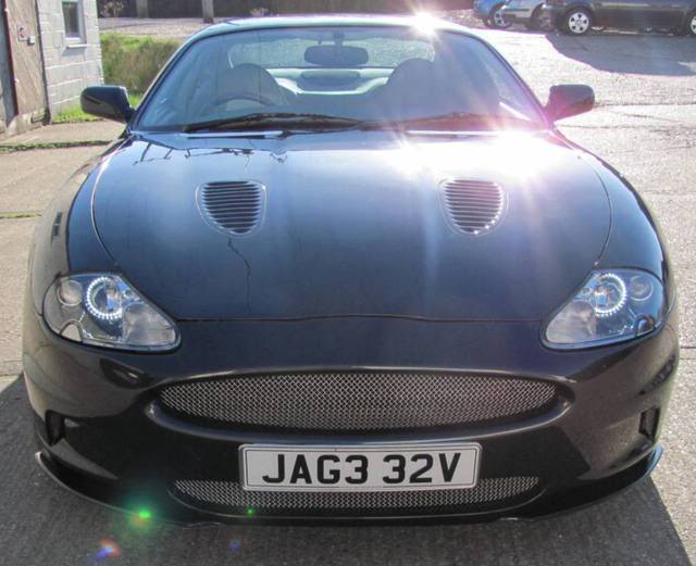

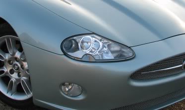

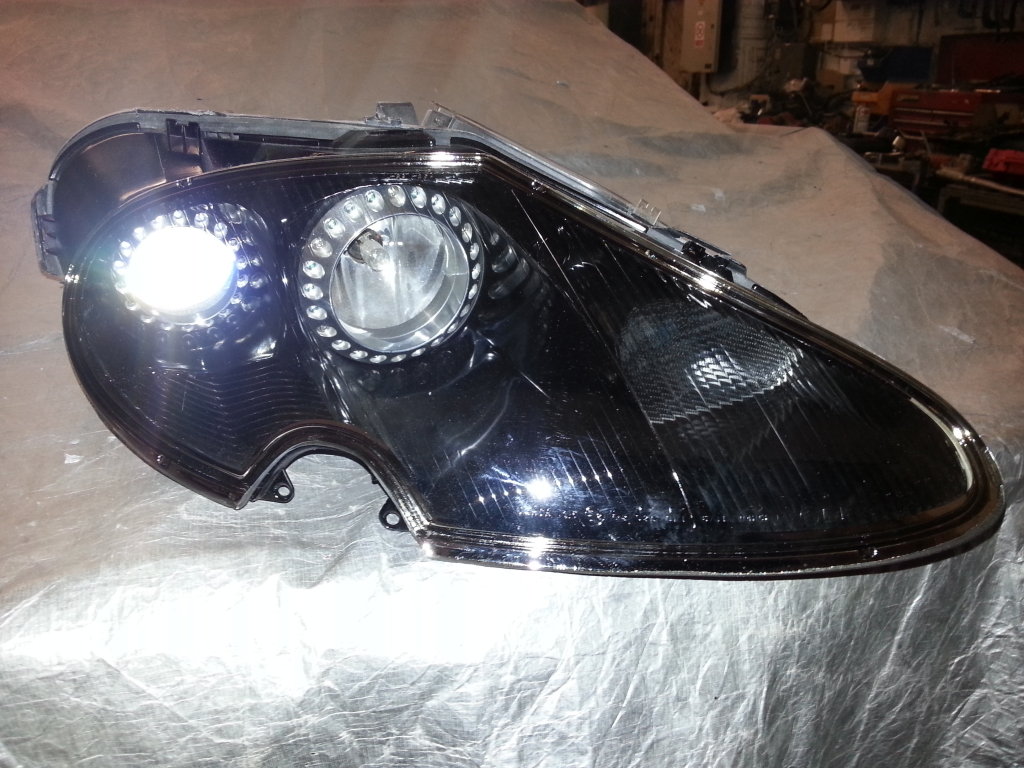

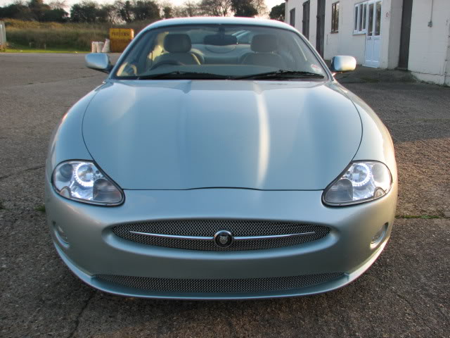

Here are some examples I have done
Attached Thumbnails I made some angel eyes / halo LED for my XK8-img_4119.jpg   I made some angel eyes / halo LED for my XK8-682c56012ebeeffa0230bf416a32c4dc.jpg   I made some angel eyes / halo LED for my XK8-drl.jpg   I made some angel eyes / halo LED for my XK8-img_1453.jpg
