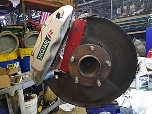

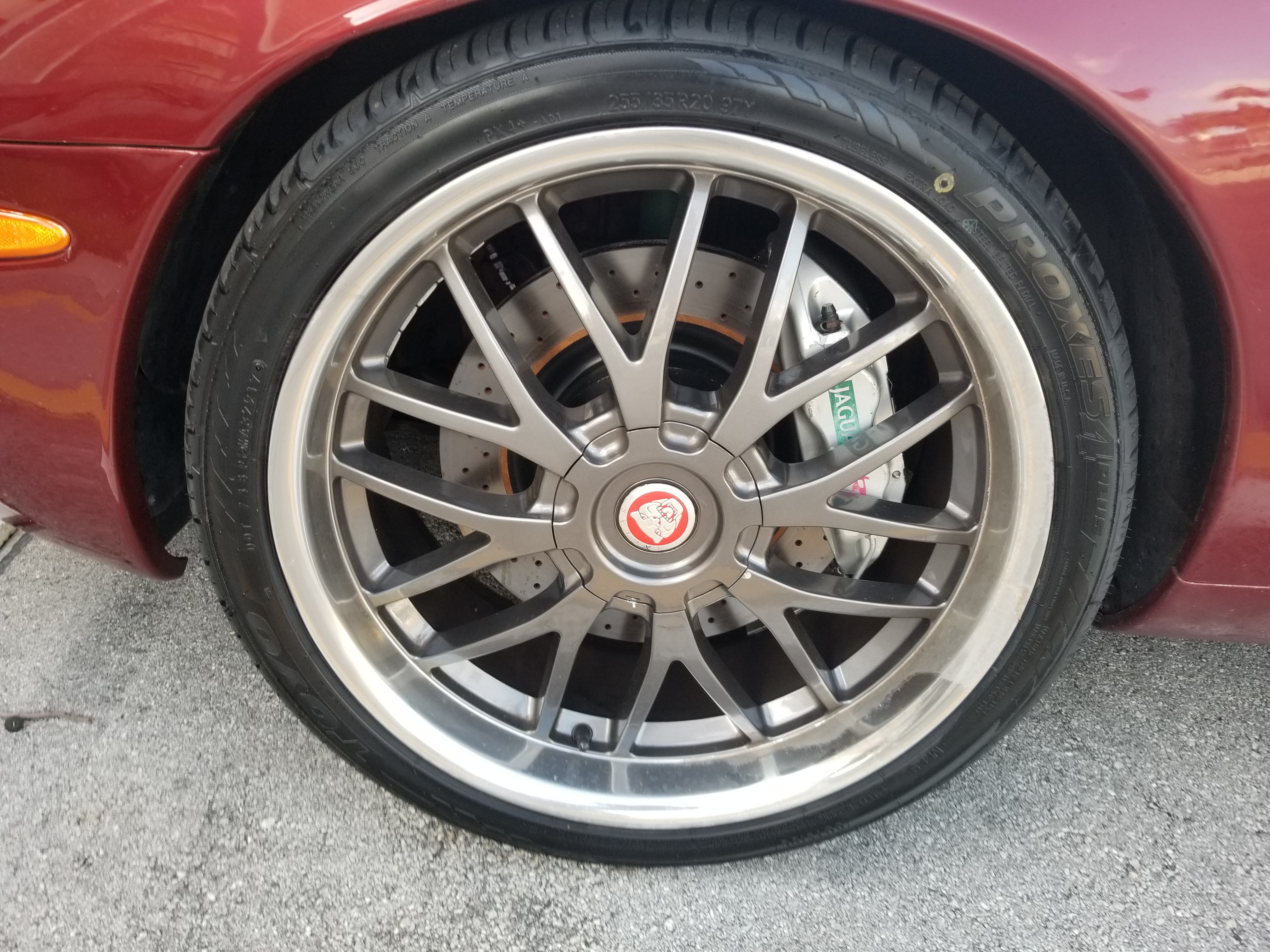

I have a 1997 XK8 coupe in need of better brakes.
I could not find anyone who makes adaptors or reliable info.
Here is what I did: 1997 To 2006 non 20” wheel xk8 xkr xj8 xjr

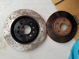

I fabricated adaptor plates to locate the 2005 xjr calipers on my existing mounting tabs. I had to have new braided brake lines made up at a local speed shop. The original rotors are 12” the 2005 xjr are 14”. I read some posts that they make no difference, but I assure you , they make a great difference. I still have to install the rears. They should be a direct bolt on with the 05 rotors 13”
Here are some pictures.

Wouldn't it have been easier to find an XKR hub and use that?

Has anyone else done this now? I can see the adapter that corryvett used and I can make a template when I pull off to do my suspension work. A question though, to those that have done this, did the 355mm discs work? I can get 355mm for the 1999 xkr but just wondered what others had done on this.

I am currently doing this to my X308 XJR. I have the 355mm discs, and I am going to make the brackets and the like and fit it up. I'll let you know if 355mm works, as the S-type R Brembo calipers were intended for 365mm rotors. However, from a mockup in the attached pictures, the brake pads appear to be no bigger than the rotor surface. The only question is, when it's all mounted up will the caliper be "too" far from the hub and have some of the pad hanging off the OD of the rotor? I'll try to update this thread when I know more. if not it should be as simple as ordering S-Type R rotors. But I suspect it will be fine.

Hey just an update for everyone. Long story short the STR calipers could be made to work, but if you try to replicate what is shown above on an XJR, there are clearance issues with the upper control arm. Its not just the bolt the actual caliper mounting tab runs into the control arm at full lock. So much to the pain of my wallet, I have sourced a set of XJR100/XKR Silverstone calipers with threaded mounting bracket just like the OEM xjr brakes. As for the back I am still going to use the XKR set that I sourced. only real reason I am "mixing" brake calipers is that's what I could get/have for a reasonable price. the only ones listed for both front and rear calipers from an XJR100/XKR Silverstone edition were upwards of 1600, while all told with a set of two-piece front rotors its coming in at about $1,400. moral of the story being, if you want bigger brakes just you're just going to have to splash the cash for XJR100/XKR silverstone brakes with the mounting bracket or the somewhat rare 05-06 XKR brembos which only require taping the front spindles. All of this information is already on this forum but I wanted to put it in one post/thread. I'll post pictures and info when the swap is all done.
