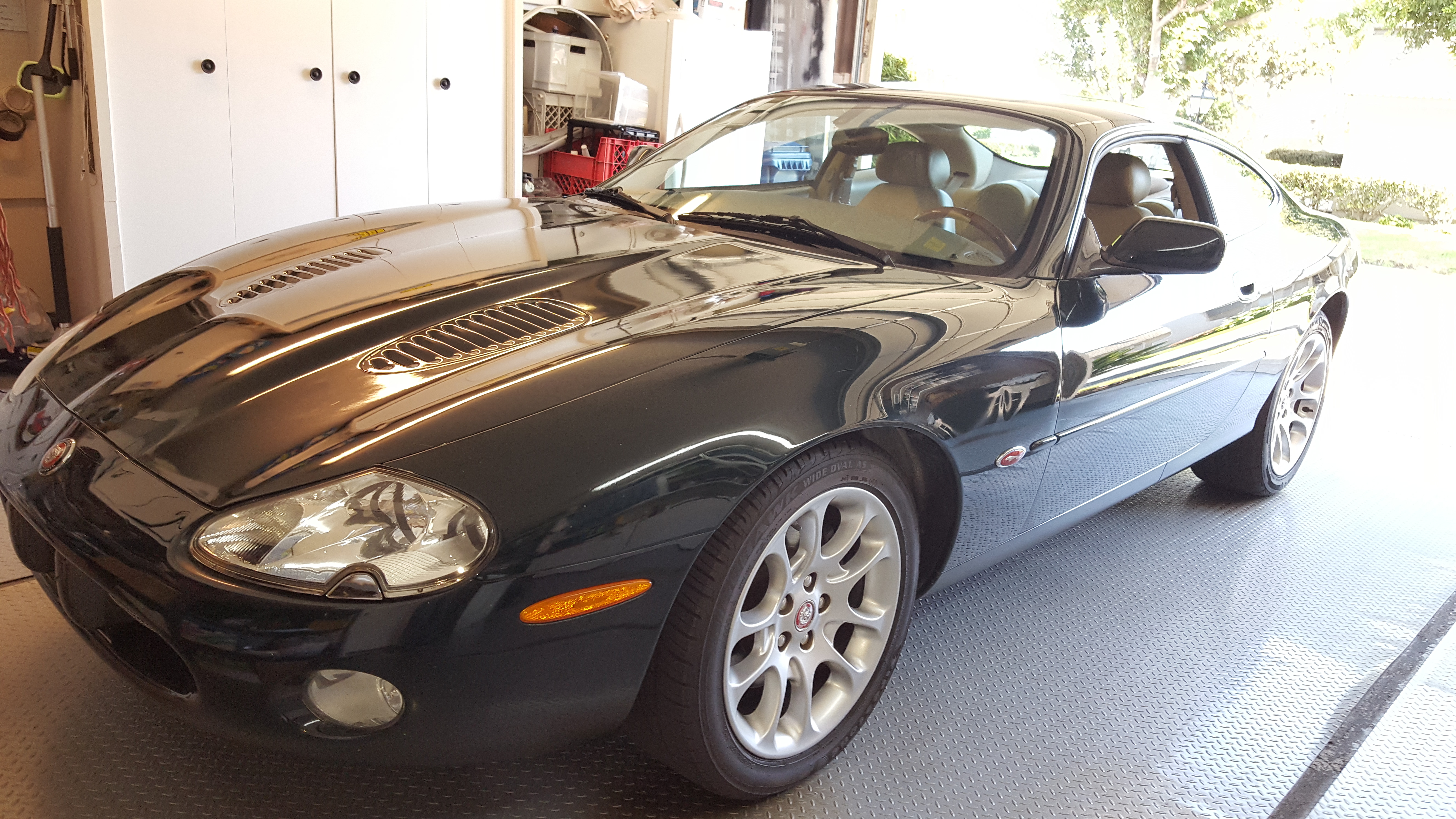

After lurking around this forum for a few months, and reading the good and bad stories, I have taken the plunge and joined the XKR owner's club. There just aren't any green coupes in So. Cal. and I found this one in Florida. Its got the usual wear and tear of a 16 y/o car, and it's going to need some TLC. I'm past the age of doing a lot of wrenching, so I will use the services of a Jag specialist. If I have have problems, the first place I will go will be the members of this forum.

nice find!!! Good luck with her and enjoy the adventure

Well found! Like you, I really wanted a BRG coupe. Mine had to be 2003 or later. The only one I could find was an iffy sounding one at a used car dealer in the Southeast. I thought I'd found a 2005 XKR in BRG in So Cal but it turned out to be Jaguar Racing Green (metallic). I didn't think I could live with that so settled, finally, for a black 2006 coupe (non-R) and had to go to Portland for it and drove it home to Nor Cal.

Welcome, and gorgeous car ! This is the right place to get info.

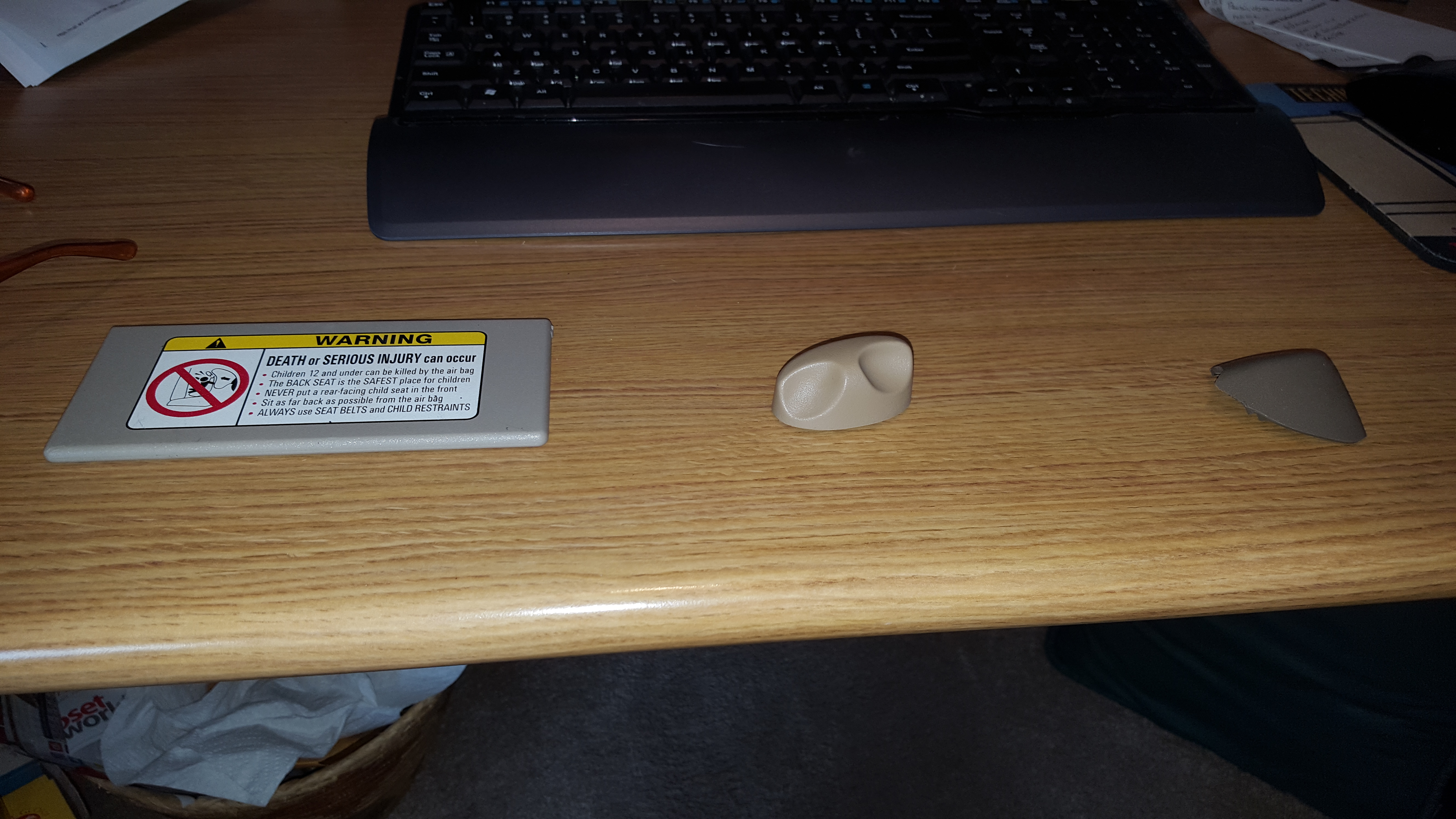

2nd-I've attached a couple of broken bits, the visor mirror door, the seat adjustment button and the enclosure that goes around the seat belt latch. How can these be fixed/repaired/replaced?
Lastly, the pass. visor clip is broken, is it possible to buy a new one somewhere?

Source for parts on Ebay...the seat button on mine was broken, not sure if you can fix it, but a new unit is $600 from the dealer...if it just popped off, Gorilla Glue or Epoxy might hold it.
visor clip may be a Ford part,,,or perhaps a dab of silicone will hold it tighter? finding compatible parts is like an Easter egg hunt

Visor clip:
Seat belt top cap

Jim, looked at the photo. I see that the front switch (moves seat back and forth) is disconnected. Does the square stalk still protrude from this switch covering's position? If so, look at back of the item in your photo. You will see it has a square female receptacle molded in. Likely will find that one "wall" of this square area has fractured. Without that properly sealed there is too much play in the connection.
Here's the problem, whatever you use must bond to plastic and must not wick into the receiving area (or you'd never get the thing back on).
No you should not just fill it with glue- this needs to remain removable.
Now that sets the stage. This one's on my to do list too. Ttytt I forgot about it. I may use Goop brand glue, it is flexible and can be broken. IOW it's not that permanent. Without access to micro clamps, I'm not sure how one could rebuild the square receptacle with the precision needed to have it work as designed.
I suppose I am making an assumption about the one failure point, if I'm wrong just let us know.
Think I'll work on mine today now that you reminded me.
