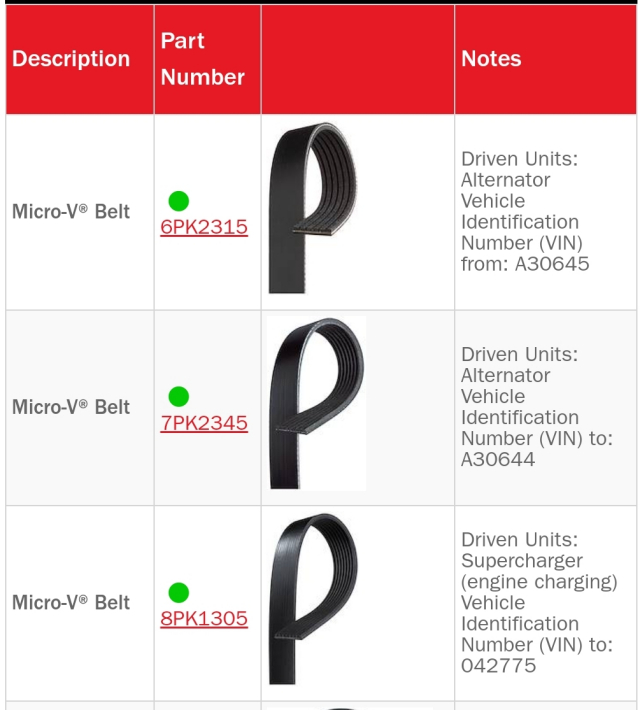

My original NCA2211AC belt is also marked 7K2327: I replaced it with a Gates 7PK2345 which, on the face of it, is 18mm too long, but the tensioner belt stretch indicator sits pretty much where it should and I've had no issues.

Thanks to both of you, is it the same part number for XK8 and XKRs ? Weird cause the latter has a supercharger to drive too so is presumably longer ?
@Jon89 What part number did you use for your gates belt ? is it a NCA2211CA like suggested by @michaelh ?

No - as above - NCA2211AC or equivalent for the XK8, NCA2211DA (supersession to the NCA2211CA) for the XKR. The part numbers are very similar.
I imagine that they will be of equal length as the route is the same. I'm not sure beyond that other than the pricing, and there is a distinction made by some vendors.

Update : checked my belt tonight and it's a Jaguar branded NCA2211DA so has probably been changed.
Question : are you guys aware of an indactor to change the supercharger belt ? As @zray pointed out in his message the belt is different (I thought it was the same) so not sure if i have to change it or not.
