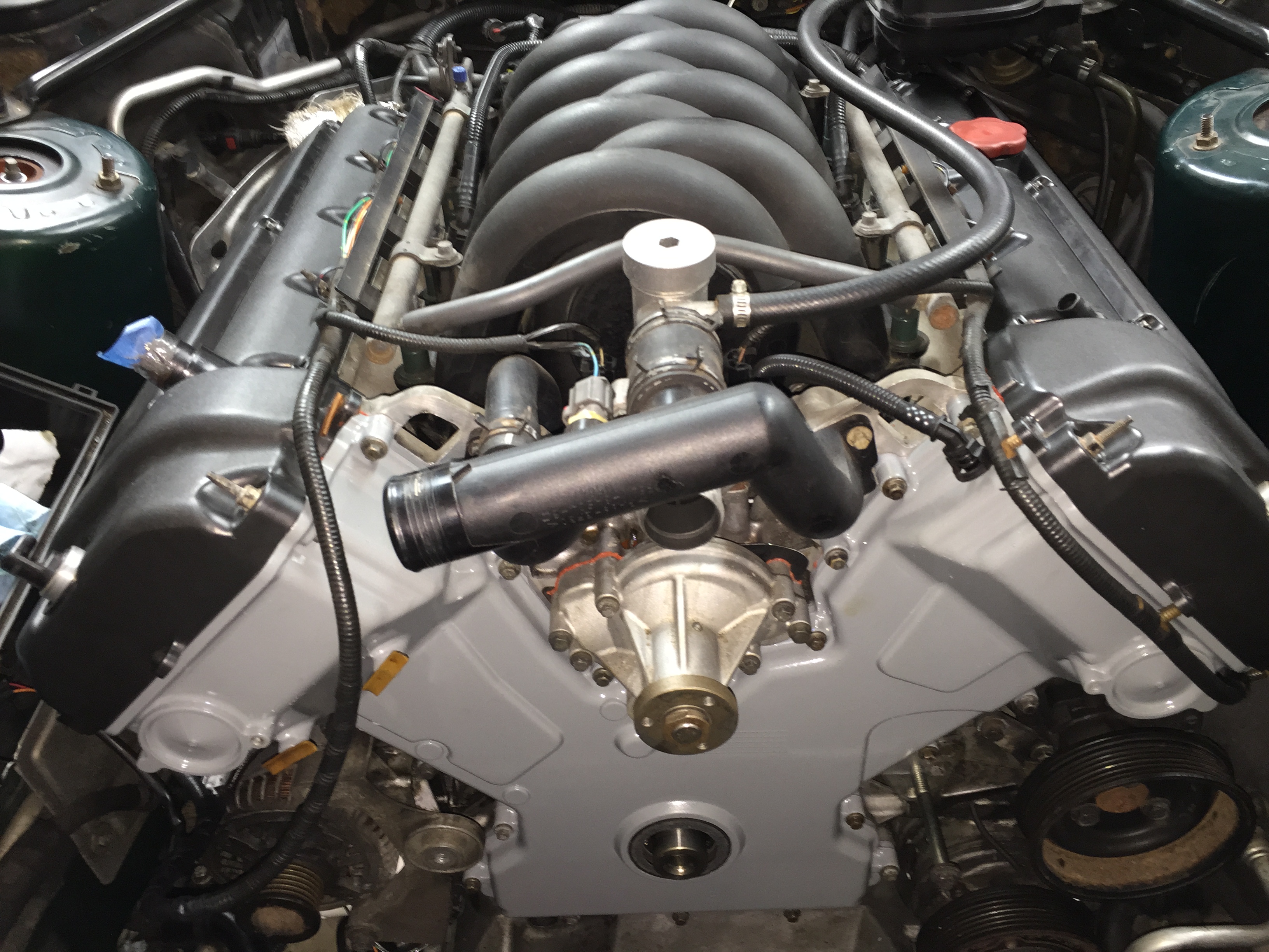

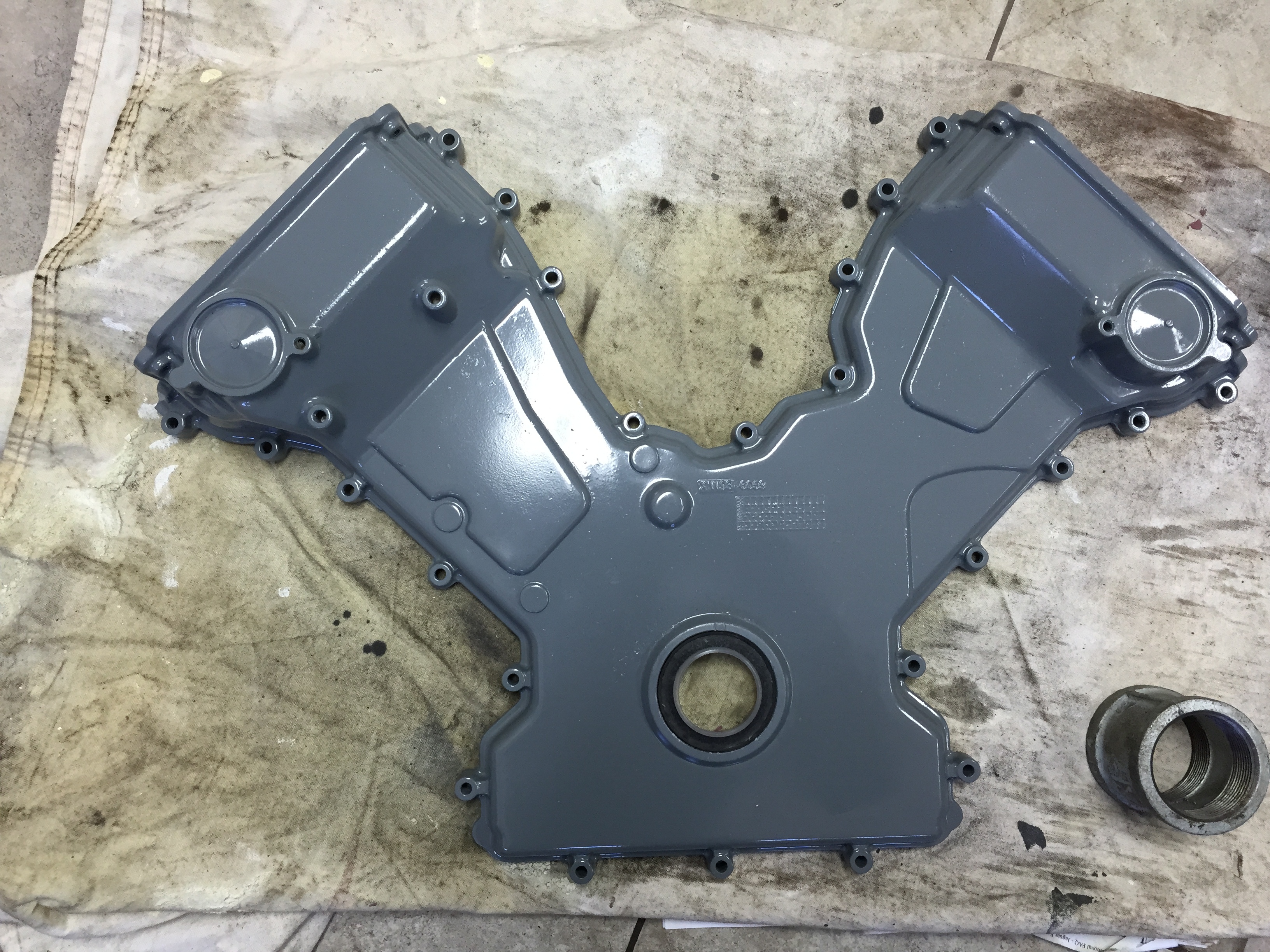

TexMurphy, I thought I would mention this. After I did my secondary tensionsers, I removed the oil pan because it was leaking from the gasket. What I found was many tensioner parts in the pump. More parts than could be explained by the secondary tensioners. I made the decision the change the primary tensioners. In talking to some people, I was told that although the car ran fine, the chain may have stretched and that I should replace the chains also.
I decided to do the full job and I think it was the right move. The primary guides were broken.
#90
Hi John,
Yep my oil pan is also leaking, but I hope I am lucky and don't find a bunch of plastic in there. The secondary had lost the shoe on the movement side but was otherwise intact. I am trying to keep it real on the cost side for now, and do some more enjoying it more than working on it for now.
You sure did a fine job on yours the pictures look great.
How bad was putting the harmonic balancer replacement? Seemed to be a tricky part getting it torqued back up correctly.

Well I have been enjoying driving and less working for a couple of months. Finally got tired of looking at the failing rear view mirror. One of those typical line and foggy looking. Watch ebay and read the articles about sending your mirror off for repair. Well I couldn't stand it, if someone else can repair these why can't I. I found a xk8 that was at a pick a part, after paying my $2 to get inside of course the mirror looked worse than mine. They had a xj8 that also had leaked but looked way better than mine, bought that one for $5 as a back up. Found a S (from 2001 I think) that had the same mirror as mine but the mount is different, so I had my donor glass for $13, now if I could get it apart and into my housing I would have a good mirror. I started with the donor mirror, it was hard to figure out how it was snapped together, you know why...it isn't they glue the front bezel on the body with small spots of glue every 1/2 inch or so. Scratch head and push with screw driver of assorted sizes with little luck, of course I wasn't that worried about the case from donor and kept at it until I got a few spots to break free and then pulled it apart cracking the bezel. At this point I could see how it went together. Now on to my original mirror, with the knowledge of how they were glued I placed a small screw driver in the seam and gave it a few taps with another screw driver so not too much force, the seam started snapping at glue joints and I worked my way around. While I did get a few small chips my mirror was separated with one clean crack in bezel. Swapped out the circuit boards with two solder joints and reassembled with superglue. I got a green light when plugged it but too dark to be able to tell it the mirror is working to dim but I think so. Will report after I get a chance to test. Verdict at minimum I have a clean regular mirror that won't have people asking what is wrong with your mirror. Easier if you can find a perfect match from xj6, or 8 but wasn't in the cards for today, but if you are ready to buy a working used unit from ebay, and you are a complete tightwad like me check with your local parts recycler worst case you waste $15 bucks.
