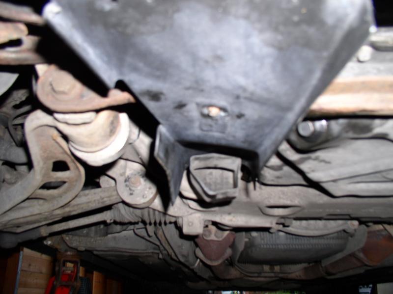

Duct on upside down.
There's a black plastic alternator cooling duct secured by a single hex bolt which conceals the filter. Apologies for the dreadful photo. Drain plug is just visible to the right of the duct:
Attachment 18223
You need to remove this duct to see and replace the oil filter which is above and to the rear of the drain plug.
Service oil change with new oil filter requires 7.8 litres on both normally aspirated and supercharged 4.2 Victory and S models.
Attachment 18223

Thanks for that.
I have had my car for 4 years, it came with the duct on the opposite way to the diagram and I have always struggled to get te duct back in, always wondering who designed this contraption. Thanks for the picture, got to love this forum. I figured it was designed to get air in and keep water out of the alternator.
