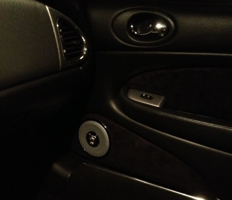

I'm working on a rear seat delete and plan to do some speaker work then. I think I'm covering a new panel to fit over the existing speaker indentation. I want it to match what I did in the front.
When I covered my door inserts and speaker cover with ultra suede, I don't realize hoe it distorted the sound so I cut a circle out over the speaker grille and found some speaker covers that looked a little vintage and used them to cover speaker. Then used a couple wheel centers to hide screws in the middle. Actually turned out to be really nice detail!! New to me XK-8 needs new speakers-image.jpg

I always like to use the Alpine G Series component speakers, they fit nicely into the original pods and sound good too
