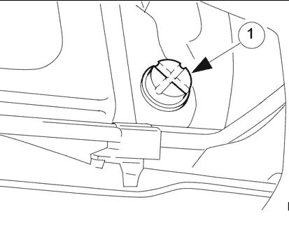

The coolant drain plug is black plastic with an X head, not a single slot:
Unfortunately I have no idea what size that coin is so I can't visualise the size of the plug.
Any signs of fluid underneath the vehicle? If not, consider the possibility of a neighbour with a (twisted) sense of humour winding you up.
