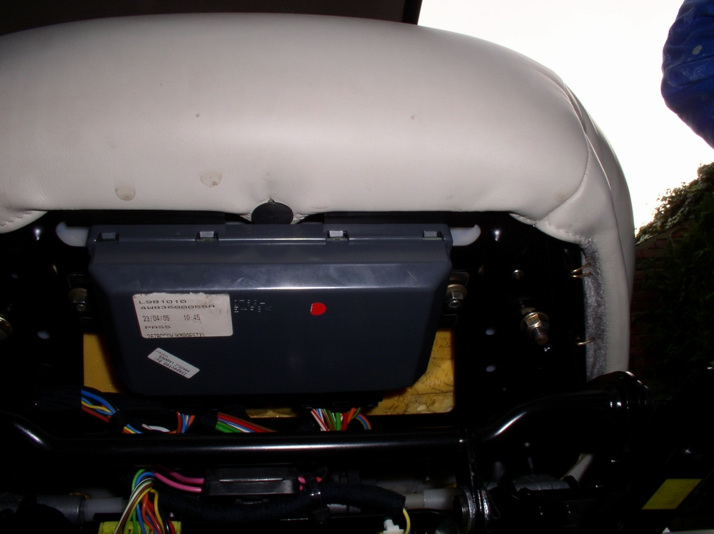

That looks different to my 2005 XK8 .....
..... bracket securing bolts are easier to reach.

My driver's seat module looks similar to BobRoy's photos, but the passenger seat module which does not work looks, as far as I can tell, more like GGG's photo. In BobRoy's photos, are the bolts attached to the module or to the seat? In GGG's photos to which are the bolts attached?
It looks like the module in BobRoy's photos just needs to be slid over and pulled our after the nuts are loosened.
