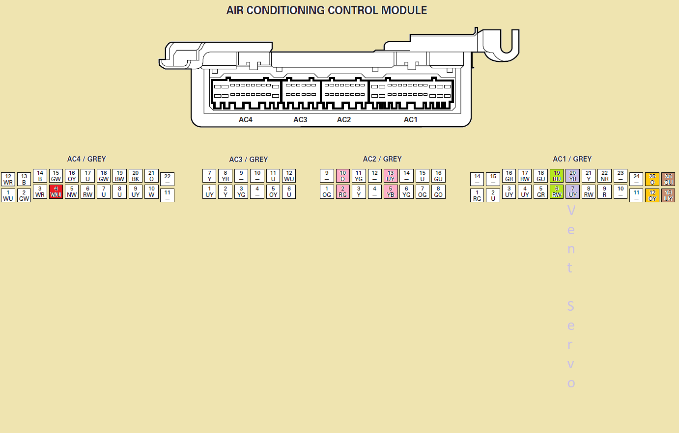

You can take a 9 volt battery and listen to hear run the servo motors and read the servo position sensors change
Over serviced and the over pressure switch inop ?
See page 110 of linked Doc for DIY self test :
http://www.jagrepair.com/images/Trai...des/703_SG.pdf
Editing
