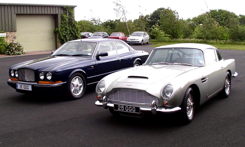

Originally Posted by Jon89
Graham,
What year Aston Martin DB5 did you own? How long did you keep it and how many miles did you put on it? And did you get rid of it because it rotted away?
1. 1964
2. 34 years
3. about as many thousand miles as I spent UKP on it
4. not exactly ..........
I enjoyed it in the days when it was possible to drive and park it anywhere. When it got to the stage I couldn't let it out of my sight, it was time to sell.

I hope it was well sold. I think I could buy the hotel I'm in right now with today's value :-)

It was well sold but the Bentley Continental R next to it lost a staggering amount in the eleven years I owned it.
We only pass this way once. No reason to travel in anything but some of the World's finest cars.

The Bentley and AM looked great together, I'm sure they were fun.
