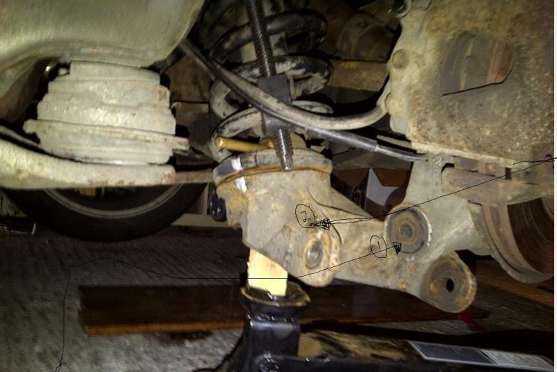

I think I found out by looking at Racediagnostics pictures what they are talking about. The back shock attachés to a mounting bracket #1 via a bushing which is standard. This mounting bracket #2 attachés to the wheel assy via a bearing #1, which is pressed in. I sent this picture to my mechanic for verification.
Bill N
03 XKR
My mechanic just called it is not that assembly. It is the bottom shock bushing/bearing??
Paul I think I will have him check the muffler bearing tooo.
Bill N
03 XKR
OK, that is the hub carrier bearing, I have had this changed too, if you have 9-3 o'clock movement on your wheel this needs changing.
This does not need a press to replace, prize out the inner sher and conical race, the you need to nock out the outer shell with a bent cold chissel, and then tap in the new bearings.
Hub Carrier Bearing Kit - CAC5846XKIT | Jaguar XJ8 - XJR, Jaguar XK8 - XKR | Jaguar | British Parts UK
wcnesta (10-09-2012)
