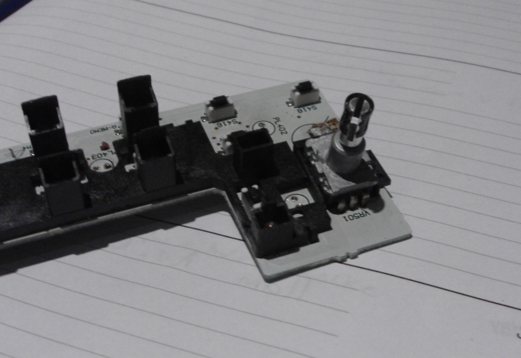

This is the earlier Harmon Karden head unit, but assuming the same construction, if you carefully "prise away" the front plastic panel, you have access to the PCB and the volume pot.
wymjym (02-01-2017)

DevonDavid, I appreciate your efforts here.
I tried removing the front face but there is something holding it on the vol control side...much more effort and I would have pieces in my hands. I hope someone with an alpine unit + experience will chime in.
