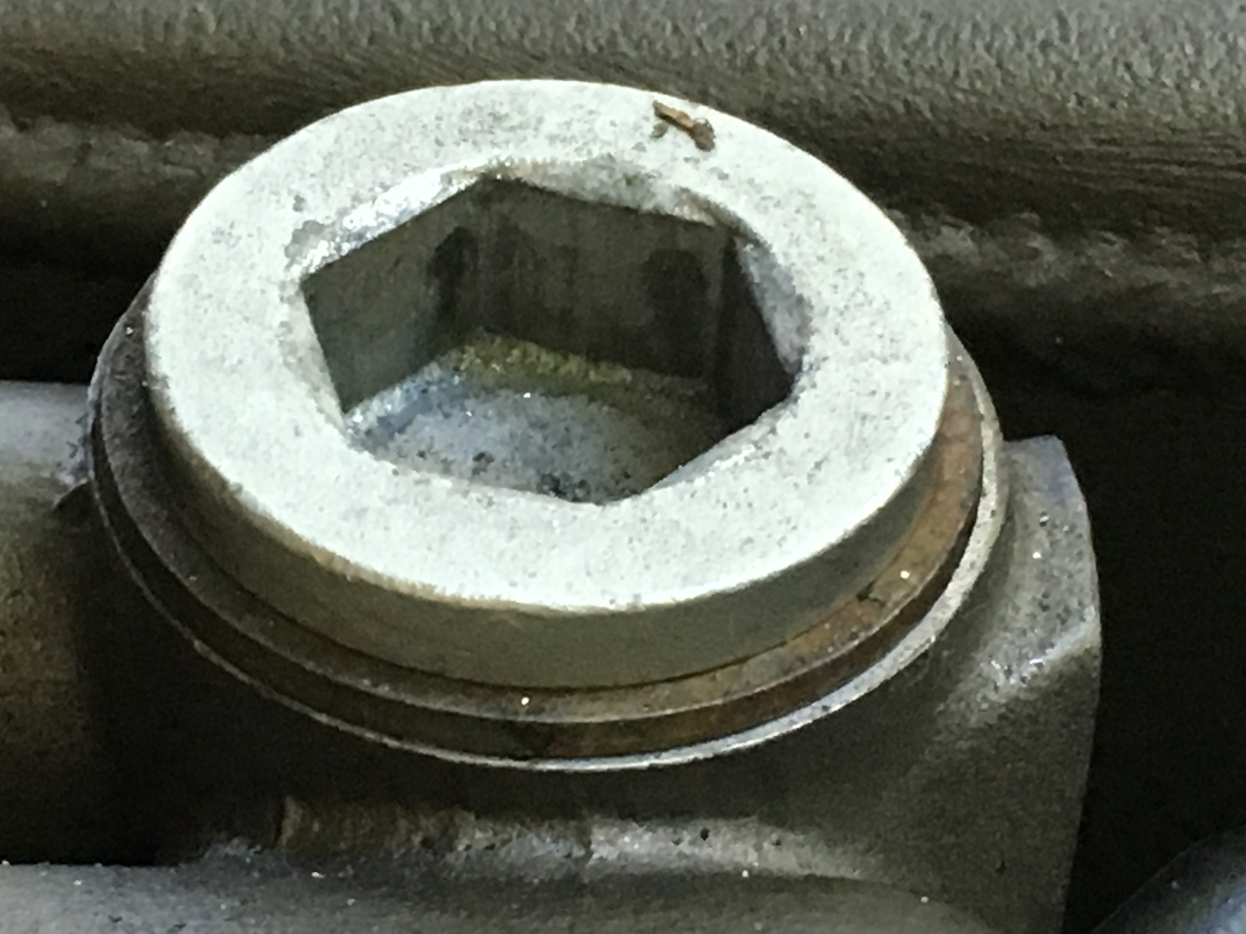

Well tried and failed again today.
Then I noticed that the plug is actually sitting on top of a metal ring that certainly does not look like the sealing washer that's supposed to be there.
I am just wondering if sometime in the past the casting/thread broke and the Jag dealer "plugged" the coolant filler opening.
Do these photos look like they should?

To remove mine, I used a 3/4" nut and a 3/4" Socket.
Put a small washer into the sealing plug followed by the 3/4" nut. The washer raises the 3/4" nut.
Half of the nut should be in the Sealing Plug and half above the Plug.
Then, use the 3/4" Socket to engage the Nut and apply lots of torque to remove.

Looks like mine: given the proximity to numerous delicate hoses, I’d suggest using the CRC branded Freeze - off. Spray it liberally all around the hex nut . Wait a few seconds then repeat.
This stuff works where heat won’t or is ill advised. Use in a ventilated area as the fumes are lethal.

I bought a 3/4 coupling nut at Home Depot. Worked perfectly: sits deep in the coolant plug and lots exposed for the socket to grip.
