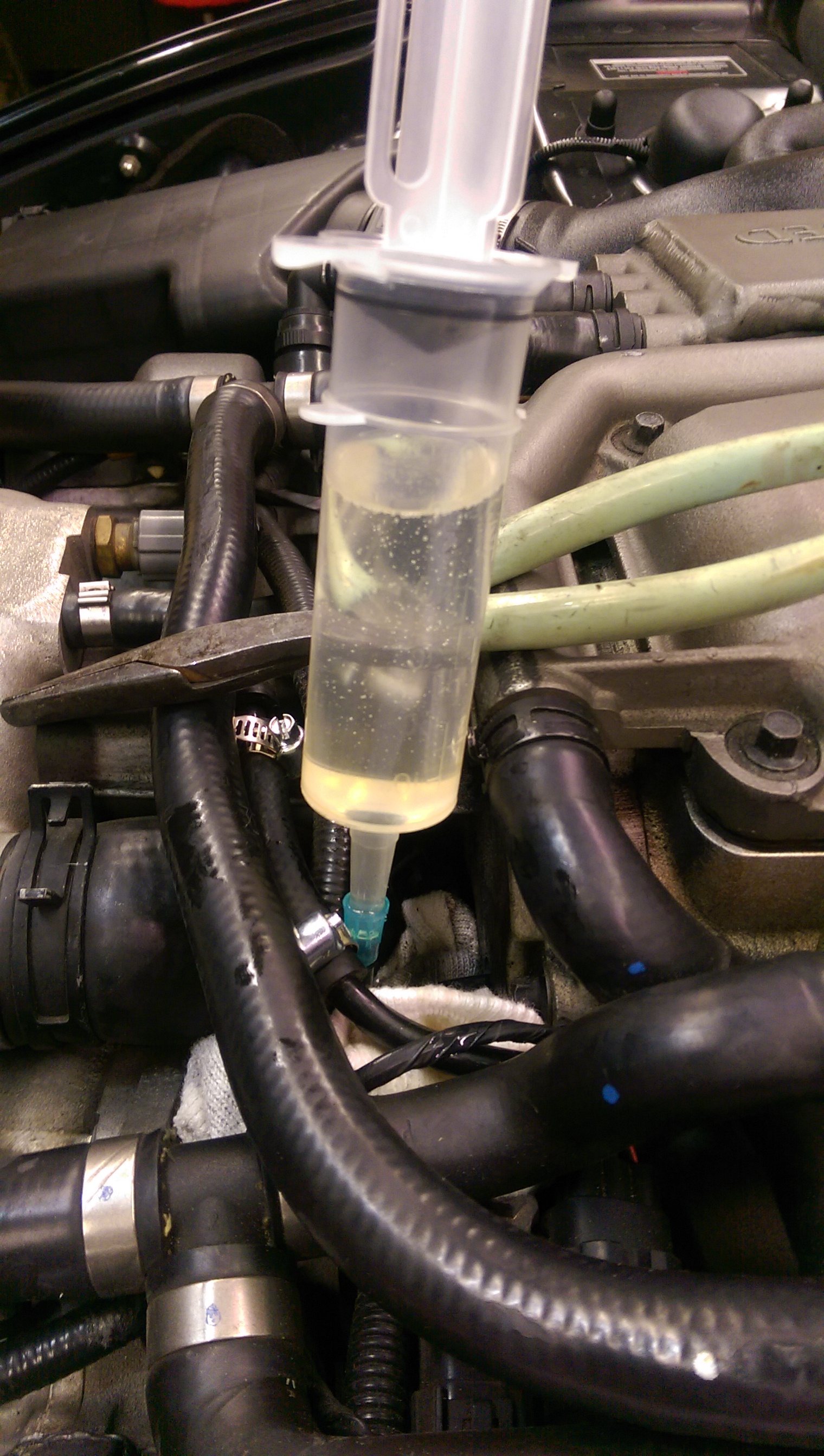

I'd purchased a kit off ebay, worth getting the syringe and tubing alone, this was fine to get 7.25 oz out.. now I have it for a number of uses and the only draw back of the 'red straw' is it's way too narrow and makes it more difficult to draw out the oil. You do have to push the hose around inside and give it a twist but it finds the right spot. Couple shots: note the pliers I used to push the tube in fully.
Attached Thumbnails Supercharger oil change-2014-12-15-17.51.39.jpg   Supercharger oil change-2014-12-15-18.19.18.jpg   Supercharger oil change-2014-12-15-18.53.27.jpg   Supercharger oil change-2014-12-15-18.32.45.jpg   Supercharger oil change-2014-12-15-17.53.15.jpg
