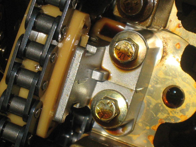

just returned from vehicle service facility. They were not wrong, the secondary tensioners were metal, in addition the timing chains looked new. From what I could see the guides looked like they were recently replaced. From my understanding, in order to replace timing chains, the natural sequence would be to replace the primary tensioner as well as guides. I purchased the vehicle in December of last year from original owner with 53K miles. He was religious in many ways in keeping the Jag serviced. I was pleasantly surprised that he took it to a new level. Took photos but not sure how to post with the text. Itold shop to proceed with water pump replacement (quoted at $325). I would be elated to find a reputable repair facility so close to my home in Scottsdale AZ. Its comforting to know that their are some honest reputable shops still in business. As a side issue, I also own a 2011 Corvette roadster which I enjoy, but it can't compare to driving the XK8.

EZDriver I agree completely. With respect to my last update regarding tensioners I mentioned that when the shop removed the cam covers on both side they found that the newer metal secondary tensioners (revision 3) were on the car as well as new chains driving the cams. The longer chain looked like original equipment. I visited the garaged and verified their finding. In order to replace the cam chains they had to removed the front cover. I'm assuming that they inspected the primary tensioners as well as guides or maybe even replaced them if needed. I took several pictures but were unable to paste them into the text. Will investigate how to append photos. Since the aforementioned still requires labor, I will report my cost for the work when I pick up the car today after the water pump is replaced.
