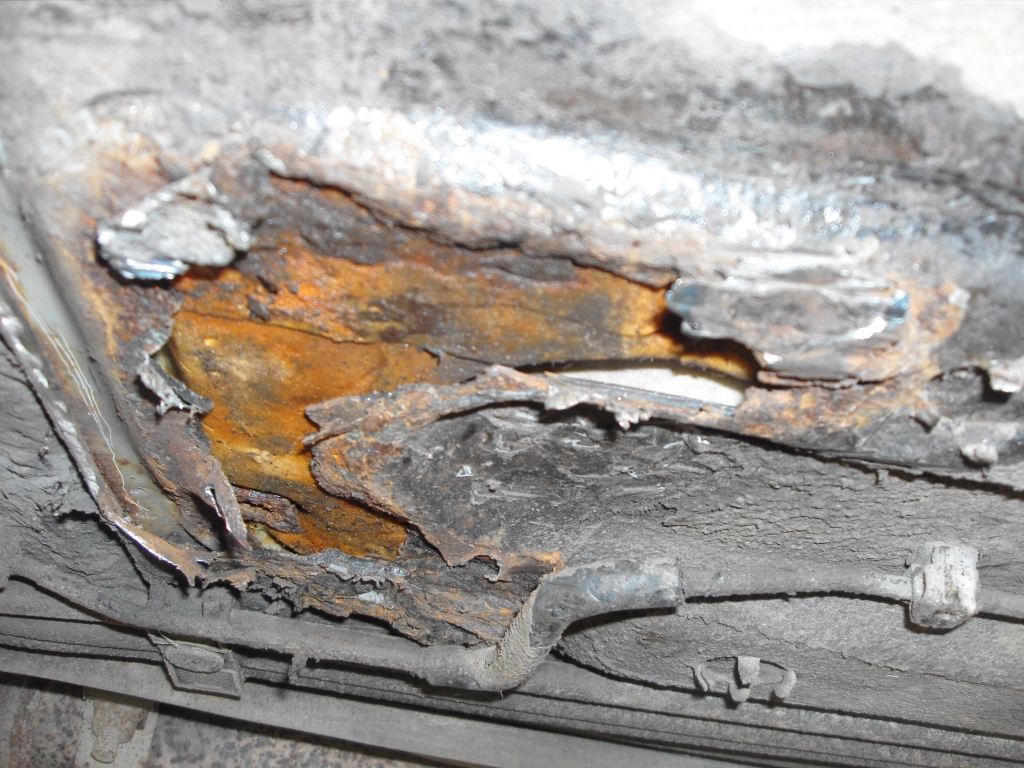

For complicated reasons to do with the assembly process and the fact that the X100 floor-pan is derived from the XJS design, there is a known issue with corrosion in the front footwells where there is an area of "double skin" between which water can penetrate and rust almost inevitable follows (unless you live somewhere it never rains).
Ideally, you will inspect the car on a lift where you can see exactly what condition it is in. Otherwise, a good torch and a mirror are a "second-best" option. If there's a nice neat circular grommet size/shape hole, you're probably OK but if there's something like this (the yellow is the underside of the carpet) - you need to be careful. Repair panels are readily available - I got mine from a guy in Norfolk - but the carpets and seats have to come out and - if you are handing the whole job over to a garage - it could get expensive.
The photo is my floor AFTER the outer skin was cut away. Before - there were few signs of what lay beneath.
You can see the grommet covered by a steel cap towards the bottom of the picture

There are metal grommets/clips that fill holes in the above area, they have 4 prongs and you can see one clearly in the bottom right of DD's picture above.
However you will almost certainly have rust there too.
