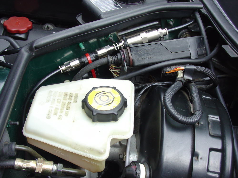

Last weekend, I finished the install of the water/methanol injection system.
It seems to work great - as the car now pulls just as hard at 85 degrees ambient air temp as it did before at 55 degrees ambient. So I theorize that the knock sensor is not telling the 'puter to pull the spark lead back.
At this time, I'm only injecting post-supercharger with twin jets, directly into the charge-air coolers for the best Intake Air Temp cooling in the hot summer weather. It's a progressive system which at this point is injecting based on boost. I have plans for more experimentation. First change will be to obtain smaller injection nozzles and add two more injectors pre-supercharger. I have a feeling (by my calculations) that I'm already injecting the maximum water that is recommended for gasoline engines with factory sized injectors at 15psi boost with these two injectors. (Aquamist #6 size) Then, I may try injecting based on MAF. The controller will do either boost or MAF.
More info coming soon...

You have the same tank that I do. I love my water/meth system, and you're right... it does pull nicely in hot weather with the system. Without it, you can REALLY tell that you're driving in hot weather. Congrats of getting the system going and having FUN!
BTW, I now mix my own water and methanol at a 50/50 ratio. It really does work better than washer fluid, but the washer stuff works well in a pinch and certainly works well enough to not even go with the highest ratio of 50/50. It seems like the higher ratio gets you about 20% more oomph than what you get with the washer fluid pre-mix.

Am now also experimenting with a Water/Meth kit and have gone with the progressive coolingmist one. Mainly for the cleaning capabilities and some extra antiknock safety, as when keeping all the same there is no power gain to be expected imo on my current setup. The pump is installed in the right fender, and am using the standard washer bottle, with a 50/50 mix (mix this myself as well).
It is tricky to get the right balance of flow and keeping power, as you change the speed of the combustion (slow it down), and with methanol you also enrich the mixture, which again lowers power. So best would be to check it on a dyno to find the best balance. Am now trying 2 x CM3 nozzles in the V8 piece, and 1 x CM2 nozzle before the TB (was easiest to place one there, but can't recommend it as KenneBell doesn't recommend to spray before the SC, which is why I use a very small nozzle only to reduce the risks). I use the boost control and start spraying from 10 psi (though may go to 8 psi), and now need to find the sweet spot by checking the a/f mixture via adjusting the duty cycle of the pump.
Just make sure you don't spray when the ECU is still in closed loop, so you don't alter the fueling strategy.
Am still not liking the refilling part (could be daily, as I do use the power and drive a lot), but as I don’t need it with the setup I have, it doesn’t matter if it’s not running either.
Already had one bad experience in that the solenoid wasn’t closing right, and sucked in fluids during coasting, not a good thing. After a new solenoid all is well, but it just goes to show that you add some extra complexity with these water/meth kits which introduces new risks.
Anyway, I just really like the cleaning part of these kits and although not needed with the boost level I run now, it does give some extra protection as well (when the bottle isn’t empty…). And last but not least, it allows for more extreme boost pressures which I may try later this year just for fun and short trips.
