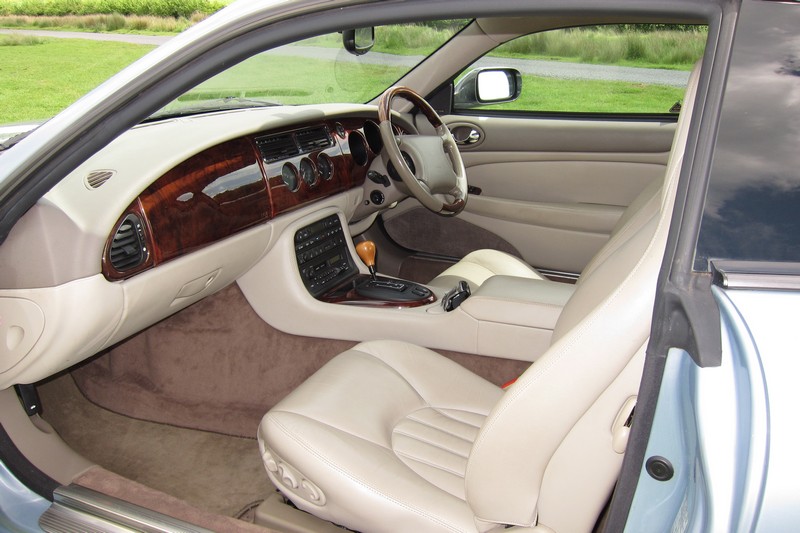

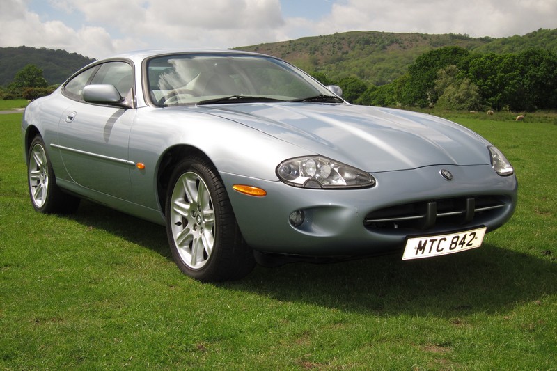

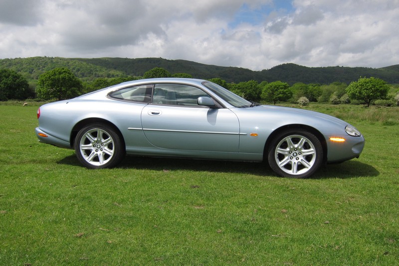

Just for you michaelh, some photos of the 20 year old beauty below (taken a few months ago).
