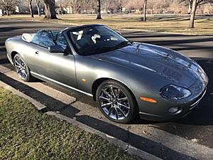

The weather was so nice today I washed the old girl and re sealed the top with 303. Then I cleaned the paint up with a clay bar and machine polished with Meguiars D151. Tied up a few odds and ends like polishing the chrome exhaust tips with Mothers polish, but didn’t get around to the interior. That’ll have to wait for another day, as I needed some time for a top down drive before getting too late.
Attached Thumbnails The "What did you work on today" thread.-a418f56a-5b29-4457-8fb6-45870fede85b.jpeg   The "What did you work on today" thread.-a1c593d9-59ce-4893-afbc-c83a543f0da6.jpeg   The "What did you work on today" thread.-e32fbd3b-4b2a-45af-a7f3-55e7e649295f.jpeg
