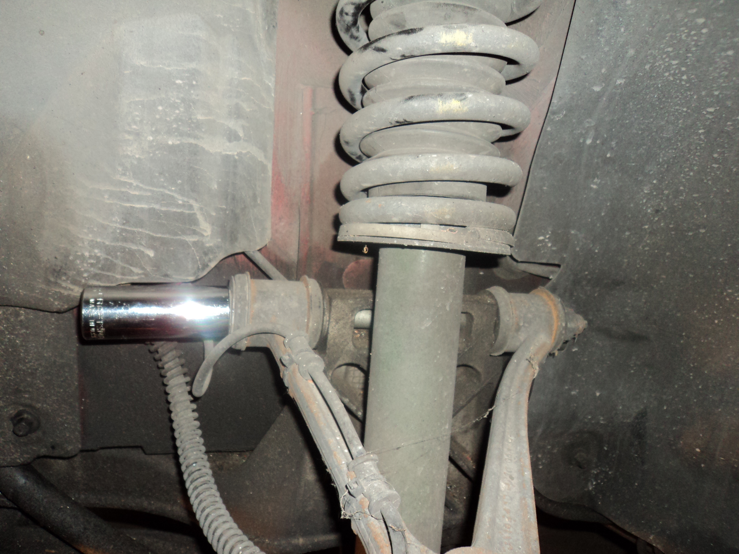

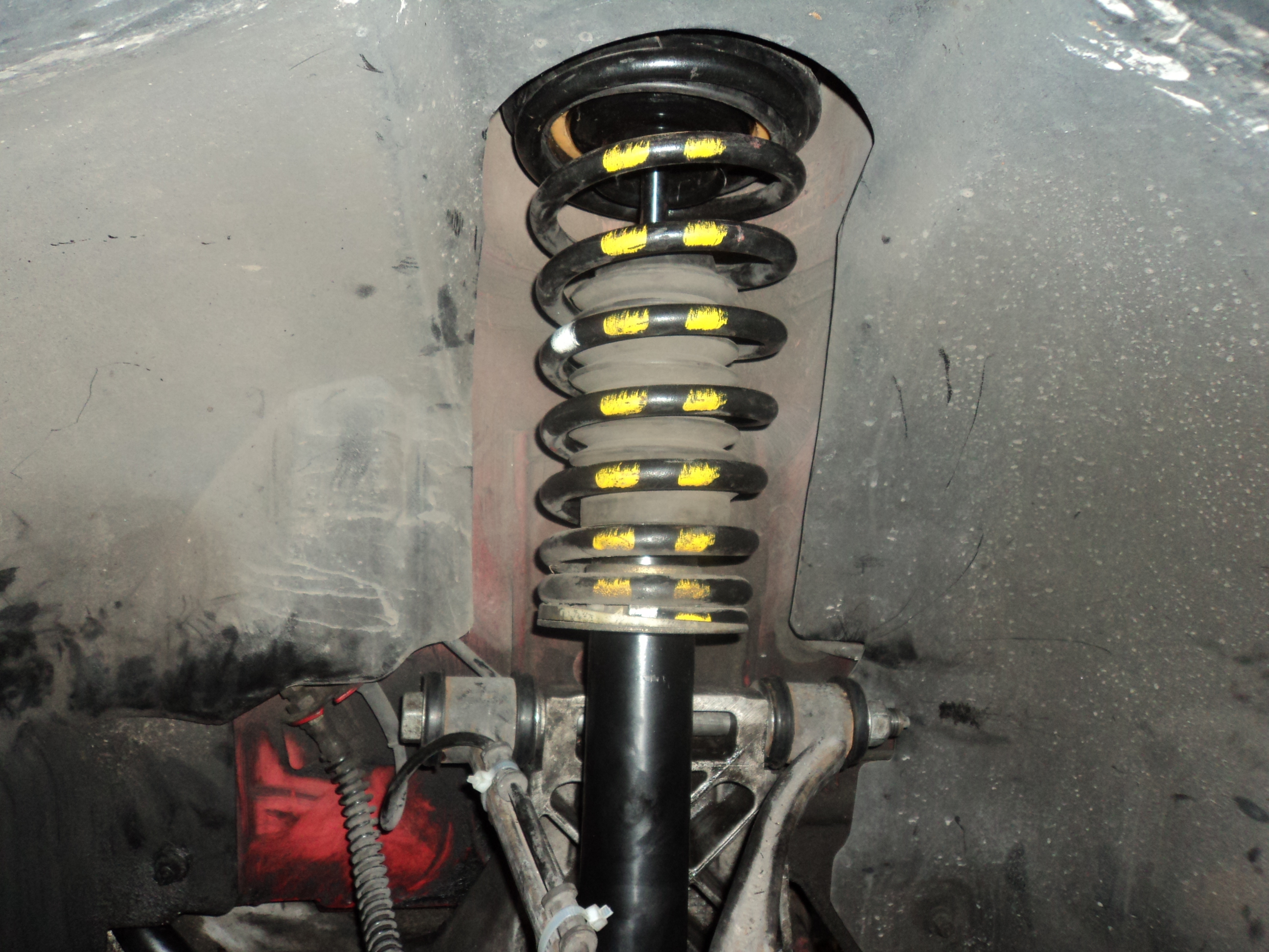

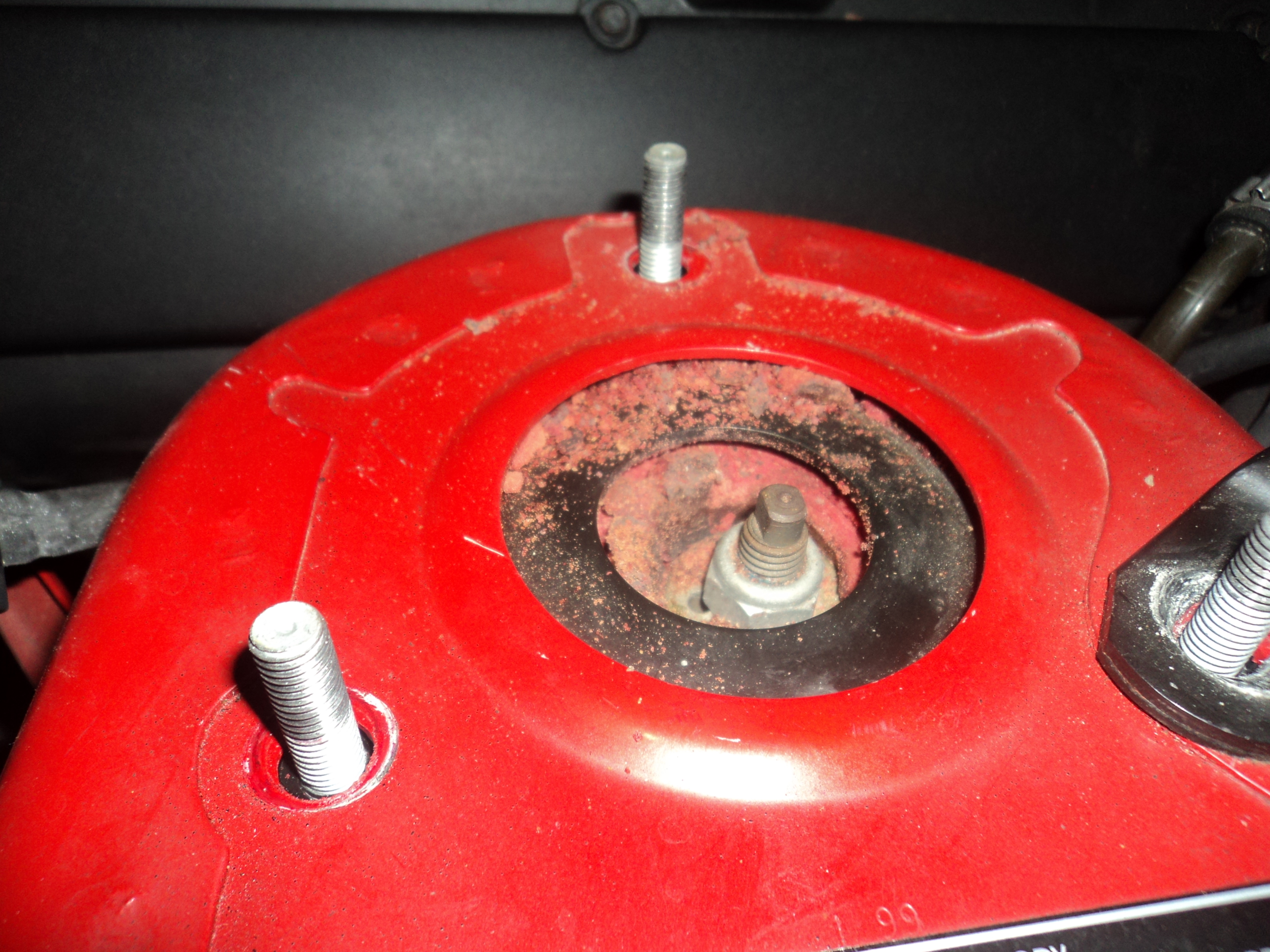

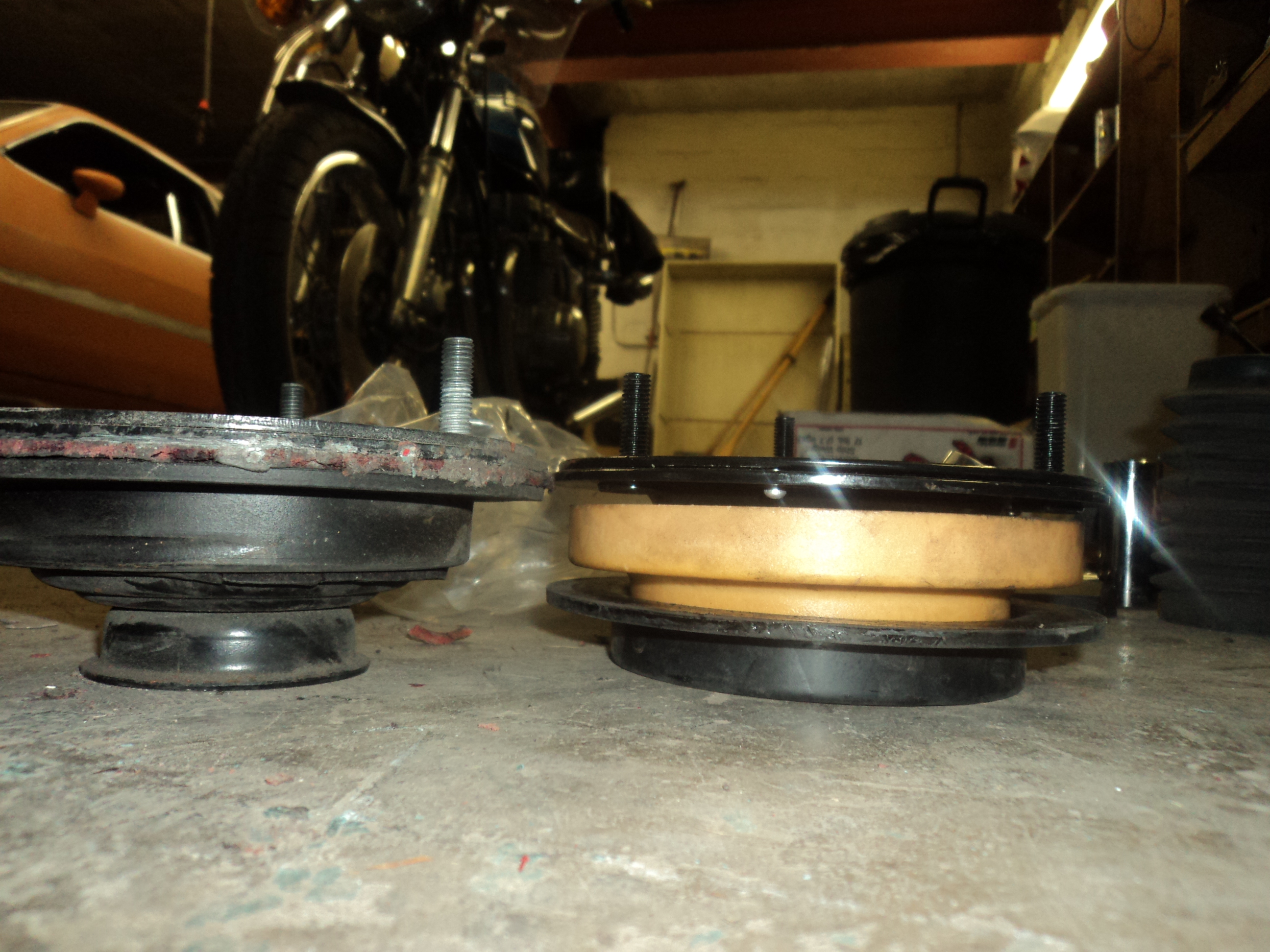

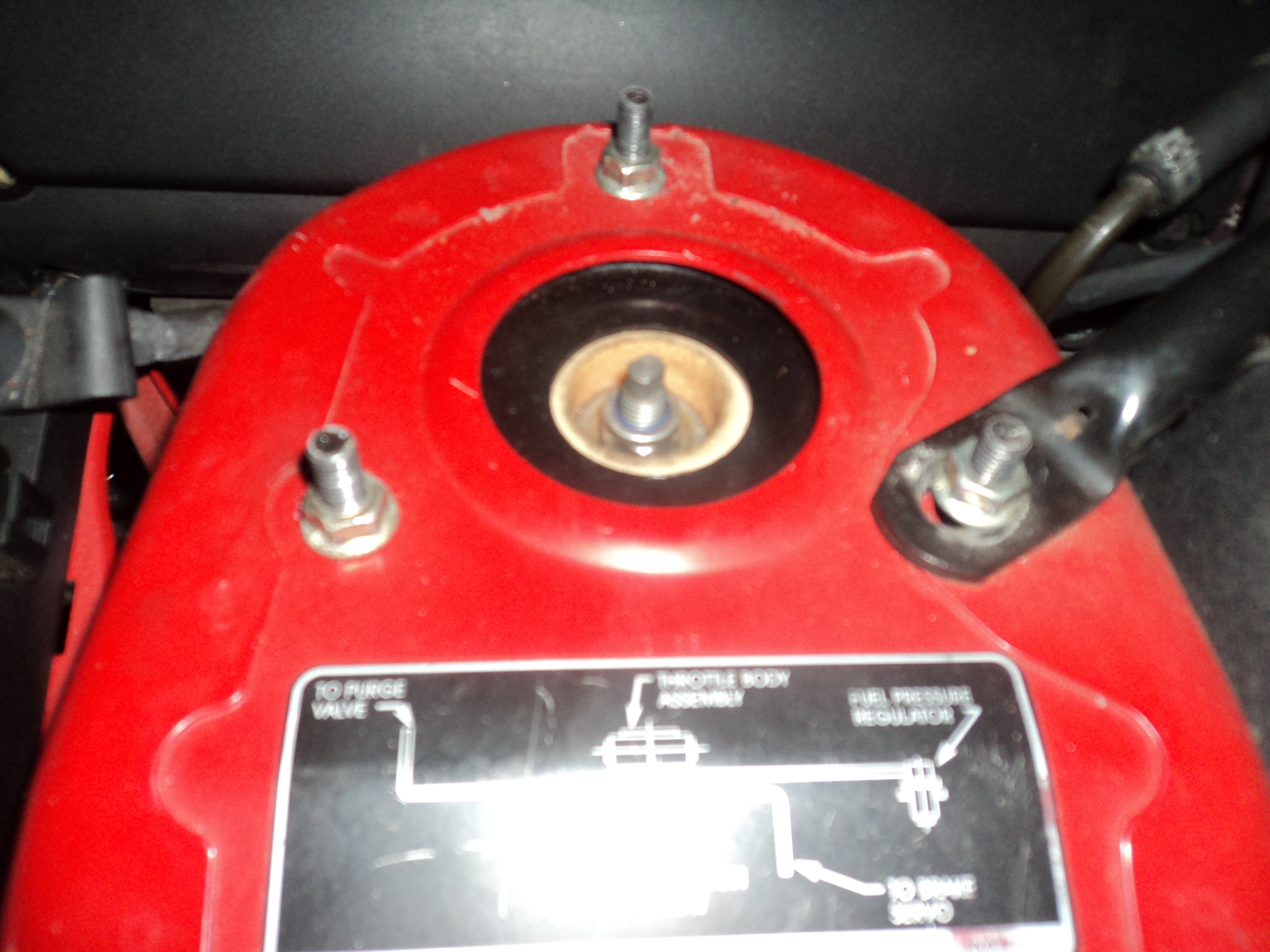

Default The more I took off the more I found bad.
Recently purchased a 99 XK8 66K miles on the clock for a real deal. Well knowing there were visual issues with the front suspension and noise issues while driving, I knew right off the bat that upper shock mounts needed replacing. Removing the tires also showed that all the brake pads were getting too close to failing inspection for the winter months. I did not want to have to change pads in February. After removing the front shocks I figures while the upper control arm had to be removed I might as well replace those bushings. That was easy. The old ones looked ok. The old upper shock mounts looked like there was nothing left. One shock was found to be beyond it's life cycle, so I had to purchase a new set. The spring assisters were worn down to a flat washer, Purchased a new set of those too. Previous owner replaced the power steering hose which left quite a mess on the drivers side wheel well. Going to clean that mess up. I could not get my spring compressor to re install the unit with the new upper mounts, Took them to my mechanic and he had them on in 20 mins. It was worth the $40.00 to get both of them installed. Took them home and installed them on the car with no problem. I hope all the interior rattles, squeaks and chirps will stop after all these new parts are installed. I did notice that the brace bar that goes from the upper shock mount area goes into the fire wall so any noise get resinated into the dash area. Next up will be a wheel alignment.
Attached Thumbnails The "What did you work on today" thread.-dsc00247.jpg   The "What did you work on today" thread.-dsc00249.jpg   The "What did you work on today" thread.-dsc00254.jpg   The "What did you work on today" thread.-dsc00250.jpg   The "What did you work on today" thread.-dsc00256.jpg

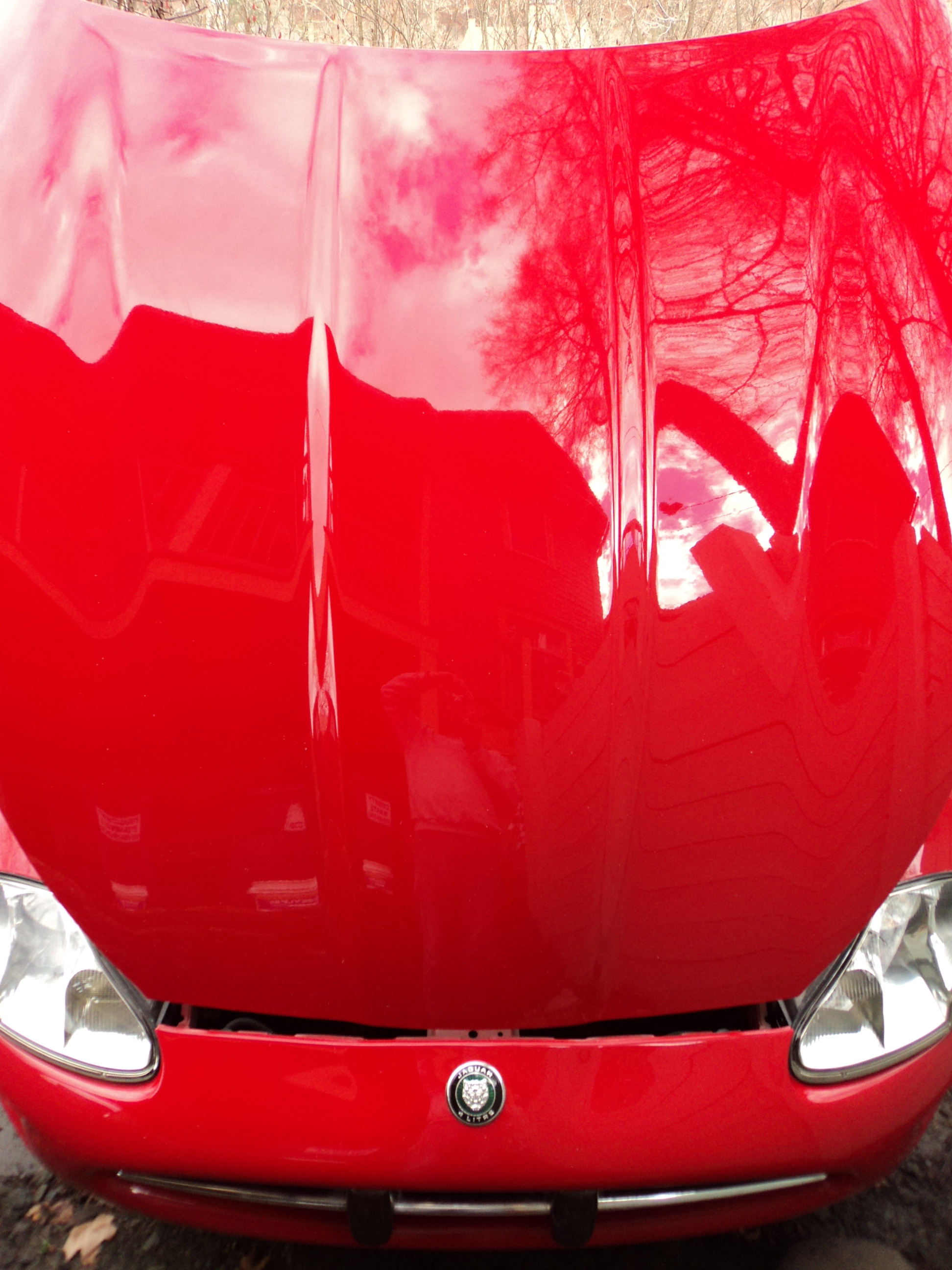

Default New Bonnet/Hood Liner
I enter my XK8 in many car shows and got tired of looking at the dull and somewhat sagging hood liner. So I purchased some SSP Foam, some 3M 80 adhesive, some edge molding and a Gold Leaper decal and went to work. Only thing left to do is install the edge molding. Turned out pretty good, very happy with the results. Hope the pictures come through.
