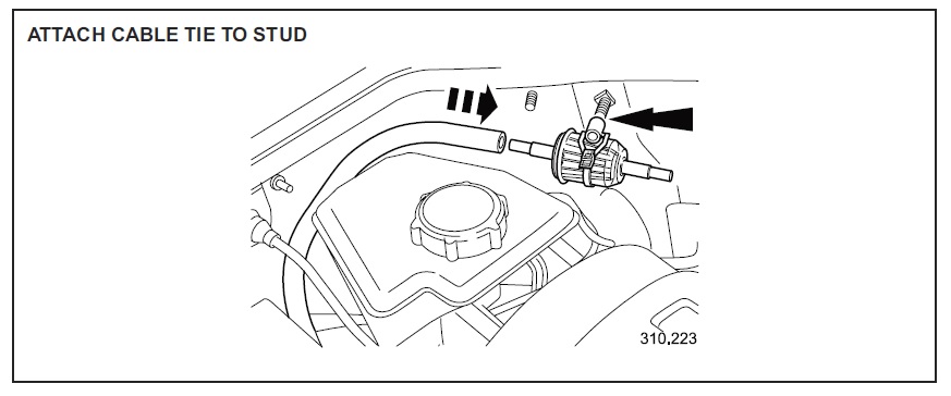

The purge valve is in the left fender area.
Not 100% positive but I think was was an evap system purge valve filter in the earlier models, then in '99-'02 they removed it and eventually added it back in this TSB: http://jagrepair.com/images/TSB/XK8/303-63.pdf (see step 15).

Anthony---
There you go. The filter you have even looks like the one in the drawing.
This is the reason I read this forum. Someone will always have the answer if they want to take the time like WhiteXKR has. You owe him a thanks.

Originally Posted by WhiteXKR
The purge valve is in the left fender area. .....
It looks more like an 'installation' than a 'bodge' in the TSB illustration.
No reference to this filter in JEPC but it's a readily available part from many sources.
