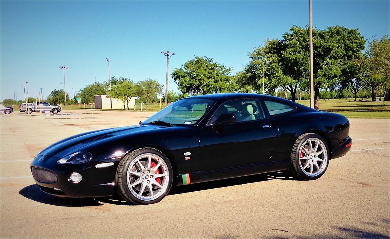

Smile Supersprint is way low!
Supersprint,
Your front fender was setting about 1/2" below the top of your Tire, when it should be about 1/2" above your Tire...It appears you have changed the Springs now as it looks about the same as mine now! They should always set where the Fender is about 1/2" above the Tire... My XKR has the Handling Package and 20" Montreal's.....And I'm assuming your Wheels are 18" Centuar's but either way for drivability, you need about 1/2"...
Billy Clyde in Houston
