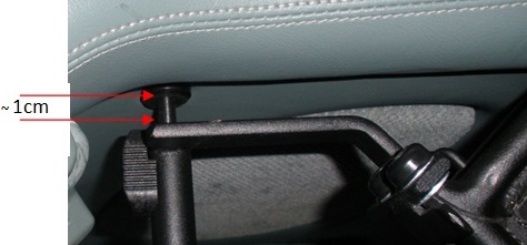

Looks good for me. I have measured the distance.
Approx one centimeter on both sides. The wind deflector is fixed.
I went on the highway around 180 km / hour without problems.

There is just no way I can get that bracket to be as flush as yours..
My pins are just barely into the grommet. If I as much as tap the deflector, it pops off.
Amadesh sent me longer pins, but unfortunately they were the same size pins.
Old 10-26-2016, 03:46 PM
XK81997's Avatar
Join Date: Aug 2016
Location: CH
Posts: 35
Received 30 Likes on 13 Posts
If I compare it with my pins, I have a distance of about 1 cm on both sides. My pins do not fit tightly to the bracket. Nevertheless, the wind deflector is firm and does not jump out of the bracket when I load it. Can the constructions be so different? It is questionable that it does not hold with the longer pins.
