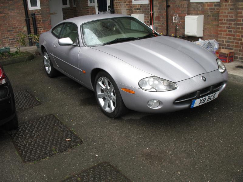

Hopefully, ( if it appears in the post) this is the best picture i could get of one of the locking nuts.
Since i was taking piccies, i thought i'd post a couple of the drivers side, which was not shown in the EBay listing, but you can't really see the overspray because the car's been rained on.
Attached Thumbnails XK8 all kinds of electrical issues-img_0227.jpg   XK8 all kinds of electrical issues-img_0234.jpg   XK8 all kinds of electrical issues-img_0232.jpg

Almost certainly an aftermarket locknut. Looks as if a key with four lugs is required to undo it. One of those reverse thread locknut removers on eBay and a breaker bar will soon defeat that!
The photos on the eBay listing made it look a respectable car and so do these ones of the driver's side. There won't be many 10 year old XK8's in the UK that haven't had remedial paintwork for gravel rash. Where's the overspray?

I might pop it down to the tyre place i mentioned earlier then GGG, see if they can get them off and buy some new ones . . . with a key lol.
The overspray is either side of the drivers door, i think the door has been sprayed, and taken off, because it hangs a bit low and doesn't always shut properly.
The hinges look good and strong so i think it just hasn't been re-aligned properly.
Theres also overspray between the upper part of the rear wheel arch, and the point on the rear lights where the white lens meets the red lens.
If you look carefully there's an arc travelling between the arch and the backlights, under the aerial.
More visible to the naked eye than in the photo's, and the rain water probably helps hide it, but hopefully i can blend it with some T-cut and polish.
In it's defense i guess, at least there seems to be very little rust on it anywhere. There's some rust bubbles on the strips around the windows, but the window pillars front and rear are unmarked, none on the wheel arches or sills, no holes in the floor lol.
There's a bit of surface rust on the inside floor of the spare wheel well, and one of the plug holes is missing there, which may be the cause.
Looks like for most of it's life it must have been well cared for, and the powder coated brake calipers suggest someone was prepared to invest a little just to make it look nice.
Perhaps it's just been let down a bit recently, in terms of care.
I live in hope lol.

Finally got my new computer now, and spent most of the evening trying to download JTIS from mediafire, which i've now managed, and have it up and running for Win 7 & 64 bit.
So a big thank you for the JTIS and 64 bit instructions guys.
Forgot to add previously that i also got my locking wheel nuts off for a tenner a wheel from the biggest tyre place i could find in my area, who had a 4 pronged removal socket and a big hammer.
Replaced them with the Evo tri-locks, which were the best i could find for the 1/2" 20mm studs.
I don't know if i could afford the chains and tensioners just yet Norri, although it would probably make sense if i could, since it seems the fans and radiator have to come out for the crank seal anyway.
I should know more when she goes in to JLC's on Thursday.
Did i mention they also gave me the radio code for free?
