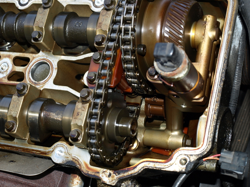

Over the last couple of weeks, the right side brakes have been refitted, the brakes bled, wheels fitted and it's been lowered to the ground. It looks spookily like a real car now.
Checked the lights for the MOT. Not being able to turn the hazard lights off is, I think, definitely an MOT failure. Certainly doesn't look cool. The leaking hydraulic fluid from the header rail had dripped into the centre console switches and congealed so that he buttons wouldn't move properly. Stripping the console apart wasn't too difficult. Then having washed it all in the kitchen sink, it seems to all work now. Yay! Another step forward. Maybe just one too many. Little did we know Jaguar 'Murphy' was about to strike.
Before starting the engine again, I took the advice on just about every thread here, and decided to check the secondary cam chain tensioners. It's only done 54,000 miles so there was a possibility they may be ok? Right? It's had a full Jaguar main dealer service history. And sure enough, the left bank chain tensioner is in one piece. However, the left revealed it had started to break up. Much sipping of coffee and time spent staring at it then ensued, I suppose we were hoping that it would repair itself.
It didn't.
See the pic. The bottom slipper has broken away from the metal, and a large piece of it was still sat on the chain case. But not all of it, the rest is probably in the sump. Erk. The worse piece of news is that the chain has been damaged by the metal of the bare slipper. This must have been very, very close to terminating the engine.
Now I need to replace the chain, might as well do the whole job. So I am going to have to remove the front of the engine. It was always on the plan, as the front crank seal leaks oil, but I hadn't quite planned to do it yet. I wanted to get it an MOT so that I could move it around. Oh well... here we go....
Anyone know where I can beg or borrow maybe even hire, the special tools needed?? Any feelings on the best and most complete kit of parts to buy over here in blighty?

SNG Barratt or Dave Roche at DCR spares will have the parts you need in a kit. Dave also hires out the required tools if I remember correctly.
Good luck with it!
