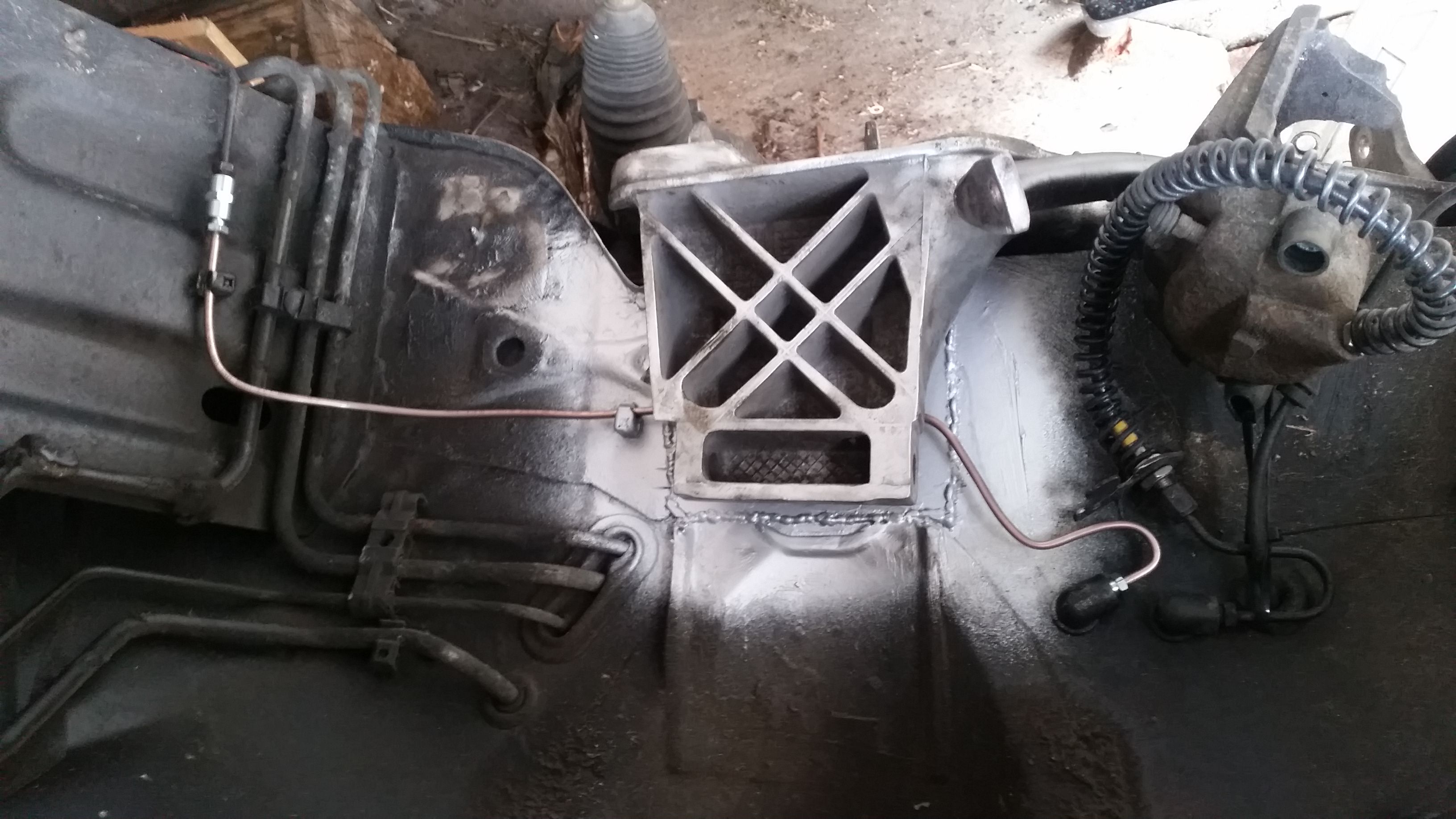

Old 03-13-2016, 04:21 AM
Jagman28's Avatar
Join Date: Oct 2013
Location: belgium
Posts: 50
Received 18 Likes on 15 Posts
Big hole under the subframe ! Also the brake lines need to be replaced

Rebuild subframe

Old 03-19-2016, 11:17 AM
Jagman28's Avatar
Join Date: Oct 2013
Location: belgium
Posts: 50
Default rebuilding front/subframe back in place
Attached Thumbnails XKR 99' Headgasket/front suspension rebuild-img-20160319-wa0006.jpeg
